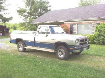

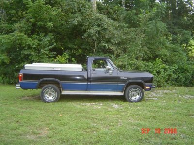

Here is my work truck done a couple years ago. The silver was peeling off and rust showing. I wet sanded and rolled on Black rustoleum thinned with mineral spirits.
It don't stay real shiney very long, but it's tough and easily touched up.
