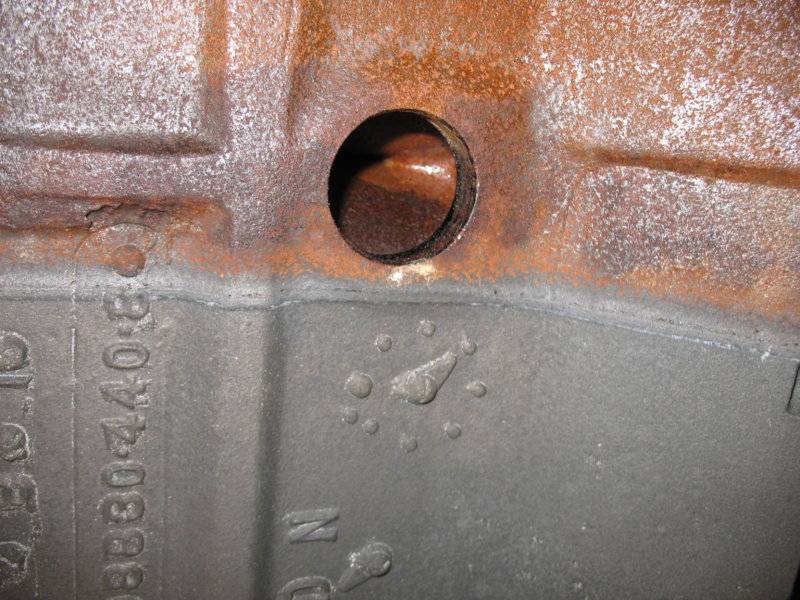

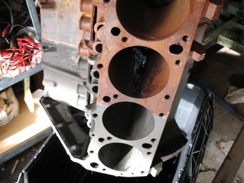

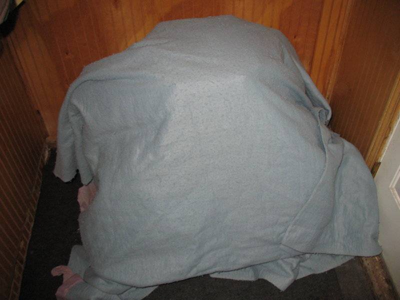

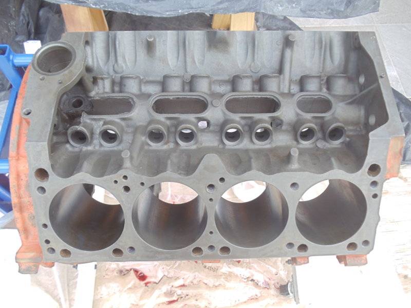

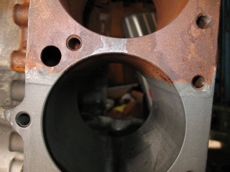

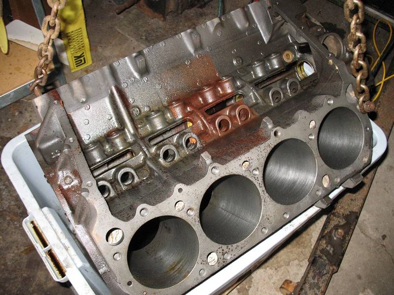

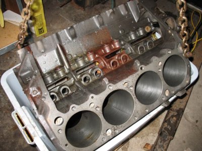

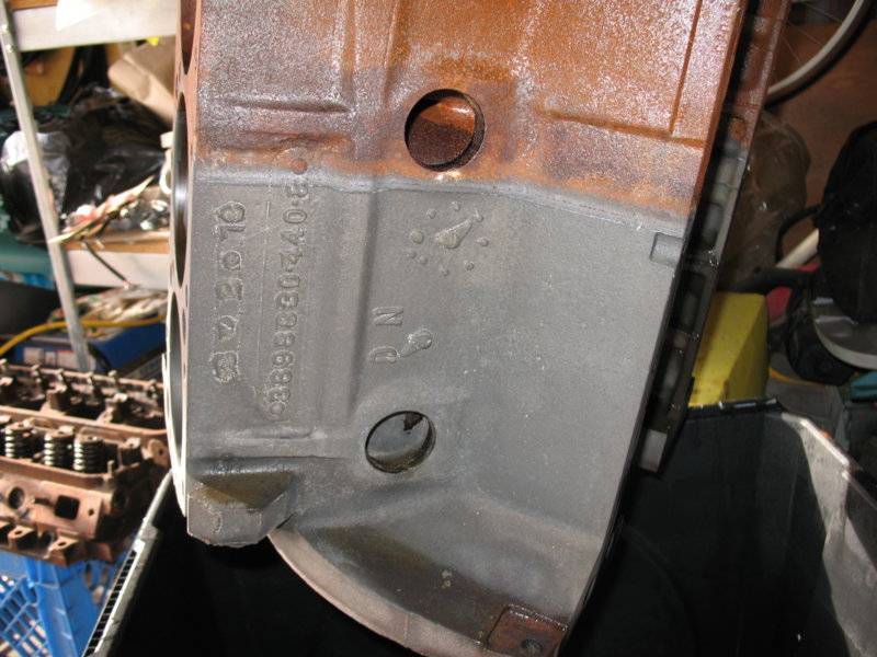

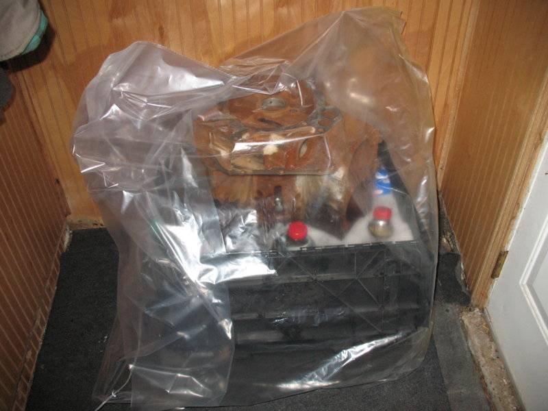

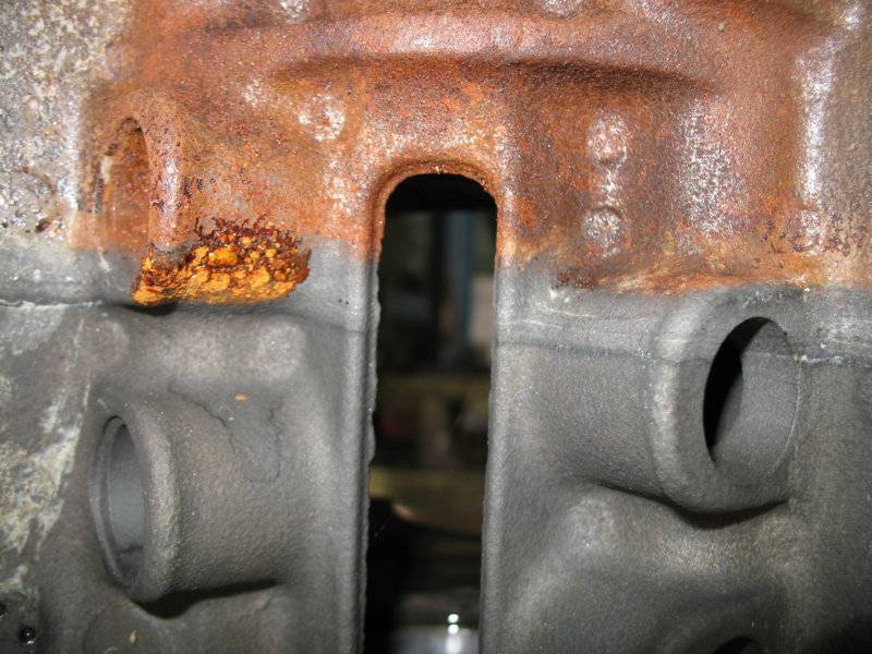

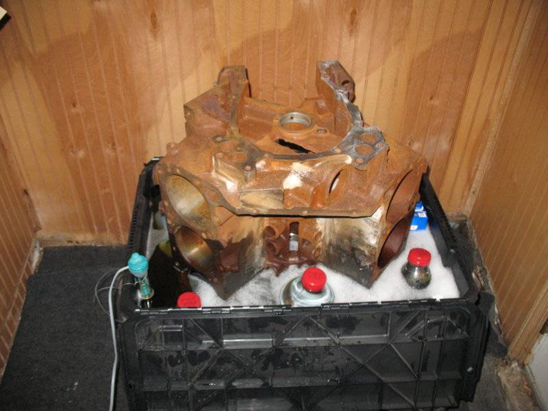

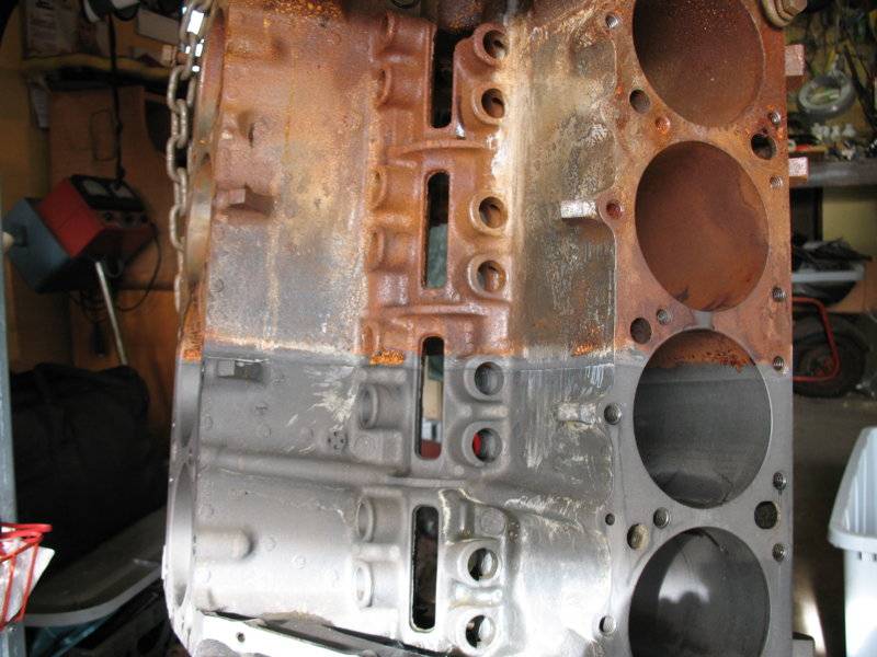

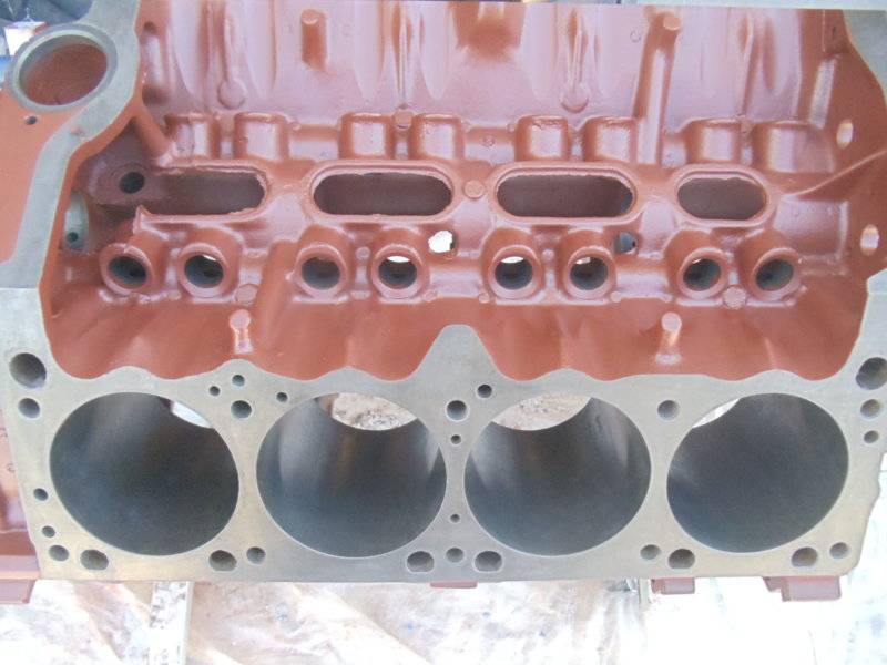

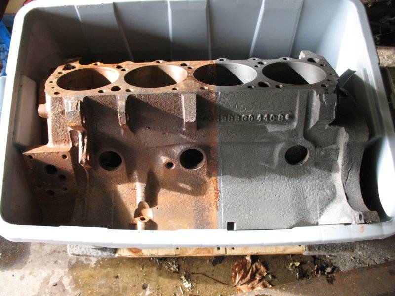

I had this 440 bored out awhile back. As it sat waiting for me to get back to it, surface rust set in. I called around trying to find a place that could take off the rust without ruining the bores. No luck. Then I came upon a You Tube video of some guys using a product called DRX. They put a small block in a tub, poured the stuff in, and it came out looking great. I ended up using Evapo Rust. Since I live in Michigan, and the stuff needs to be used at 65 degrees or warmer, I did it in the mud room of my house, which is only partially heated, using an aquarium heater. Because the stuff is not cheap ($75 for 5 gallons), and I was doing a big block, I had to keep turning it to get it all done. Here are some pics. I think you will agree it does a great job. You can actually get it on your skin with no ill effects.

How long did the process take?

I’m a big fan of Evaporust. The cast parts will kill it really quick.
I think you could have had the engine cooked or tumbled without effecting the bores. It would need re-honed but it looks like it needs re-honed now.
That is impressive! I've got a block in my garage in similar condition. Definitely gonna give evaporust a try after seeing this.

I left it in on each side 2 days, although that might have been longer than needed.
Both of those methods would require another boring. Another aspect I contemplated was that the other methods also would not have gotten into the water jackets and oil galleys.

As I was looking for a solution I heard of different acid based stuff, but safety, cleanup, and disposal all seemed to be problems. Evapo Rust is water based. It can also be reused, so you can put it back in the container for future use.

Here it is after soaking 4 sides in the solution. As you can see, it didn't reach all the way to the middle, but I can hone the lifter bores and wire brush where it didn't get to.
