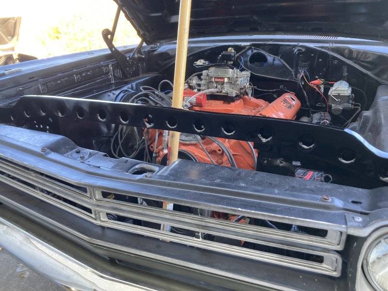

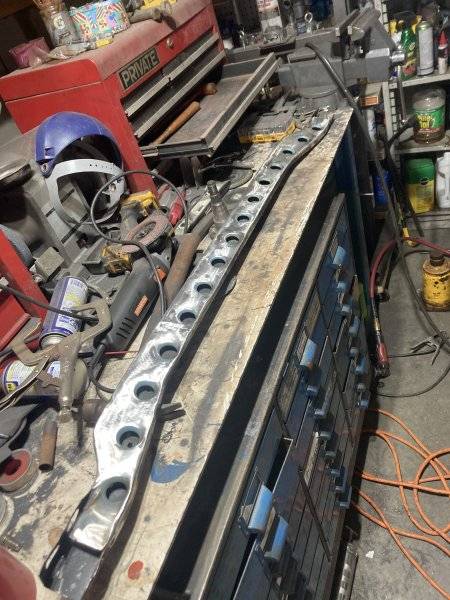

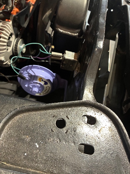

A little custom touch I did here with the radiator support. It was all bent and flimsy before so made this brace out of some sheet metal and welded it in. For the dies I drilled a hole, put a socket under neath it and stuck an old spindle on top of it and pressed it together and made perfect dimple dies.
