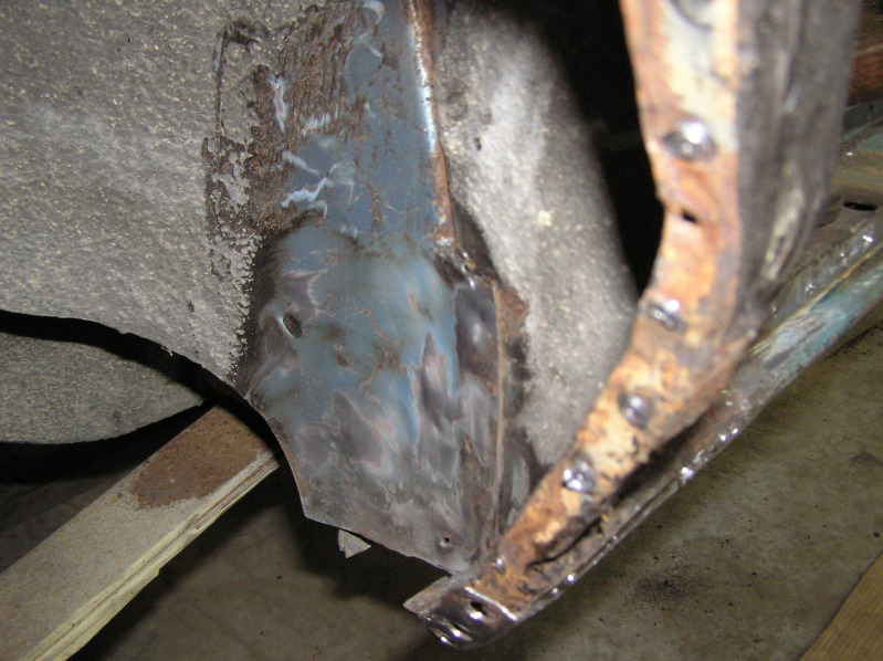

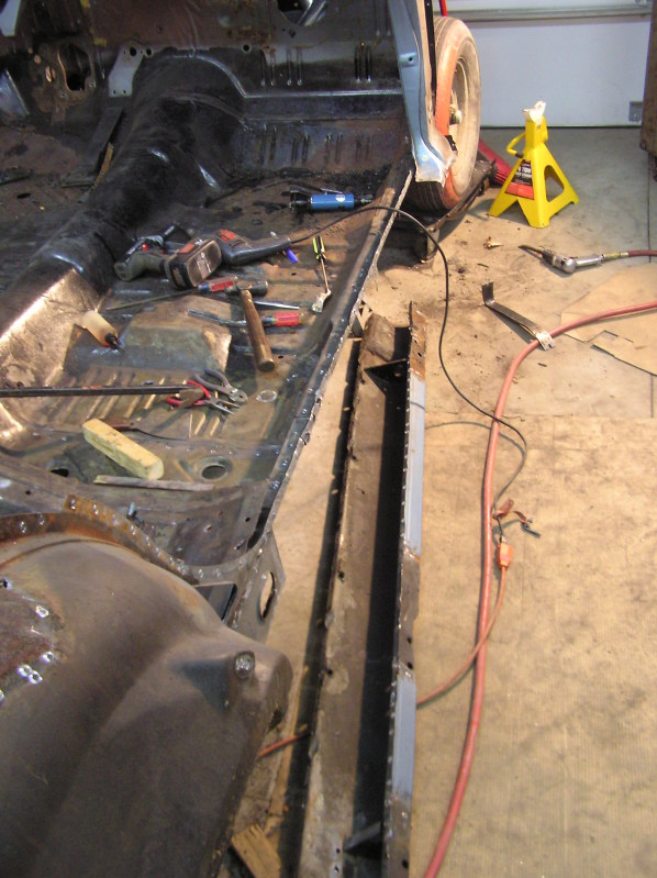

Now it was time for the rockers where I started on the passenger side.
Spot welds galore! Thanks to this site I knew there were some spot welds on the inner wheel house so I removed those.

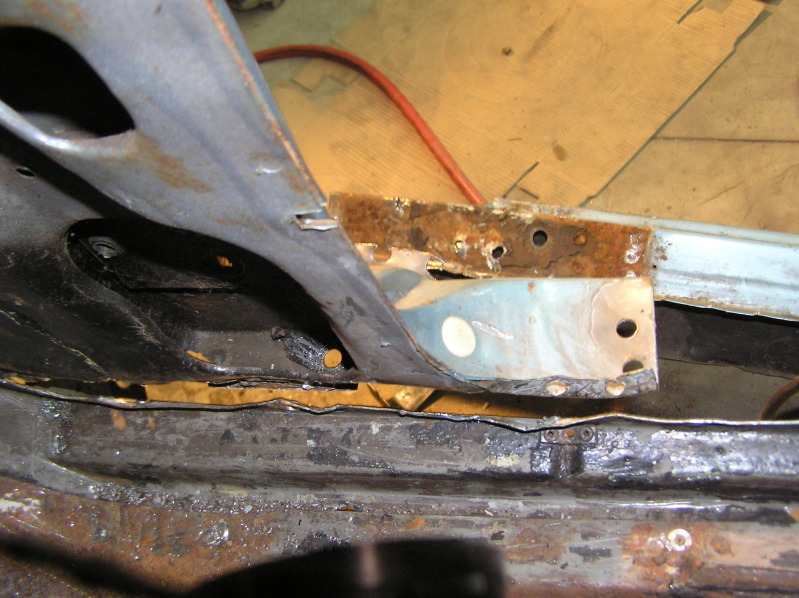

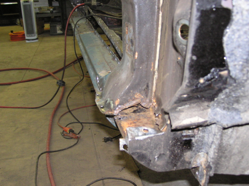

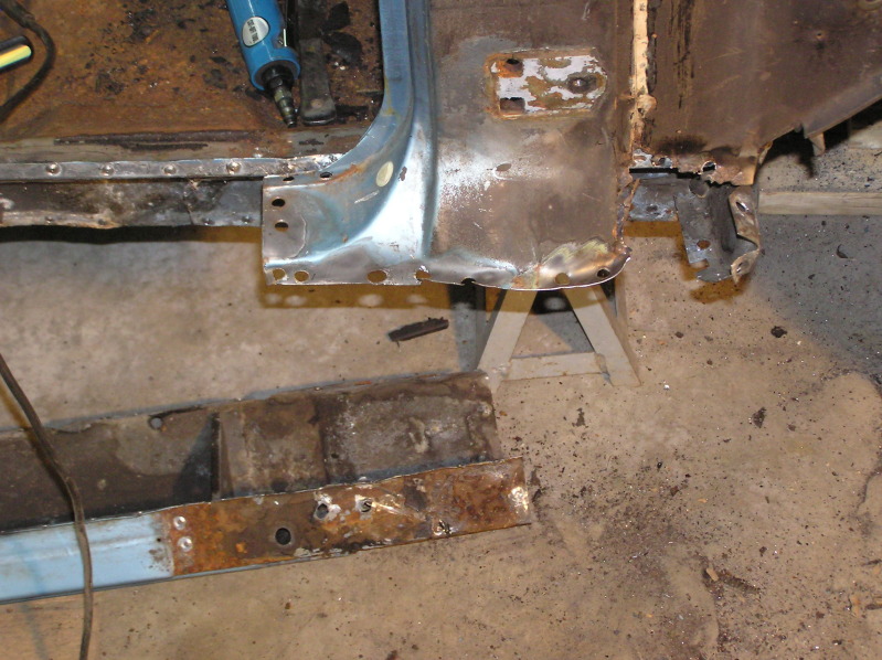

Then I moved to the front A-pillar or where the front of the jam meets the rocker.

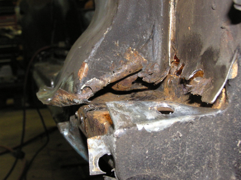

The biggest problem I had, was not realizing there was a spot weld or maybe it was a factory weld, inside the A-pillar.
I didn't know this until I had pried the rocker down far enough to see underneath it.
It took a while, (a day and half) but I finally got it!

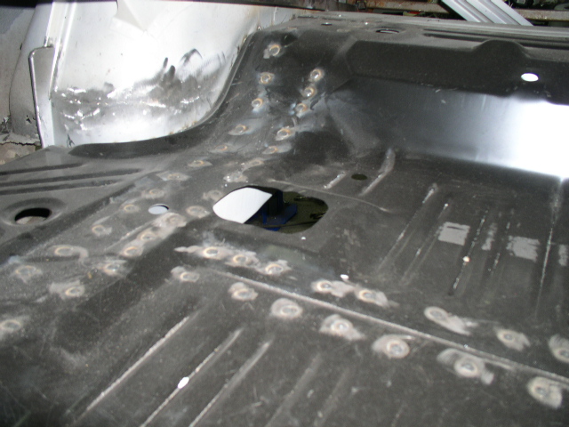

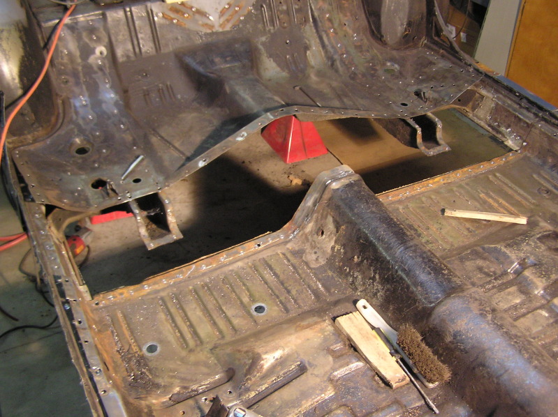

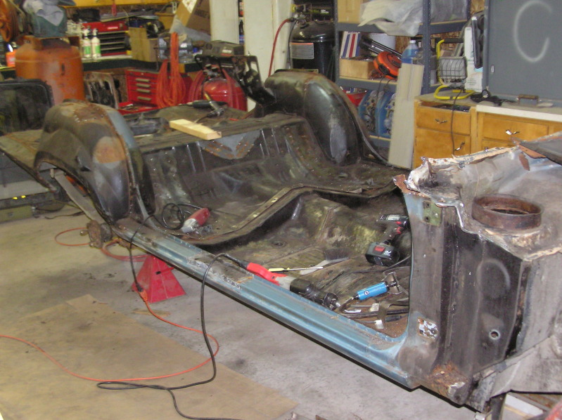

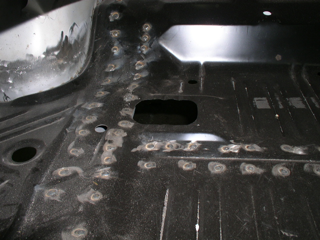

Next I removed the foot well floor pan.
A big plus to drilling out original pans is that they are then pre-drilled for the install.
AMD pans you have to drill/punch the 200 some holes to plug weld them in.
Also there are about 5500 welds on a car.

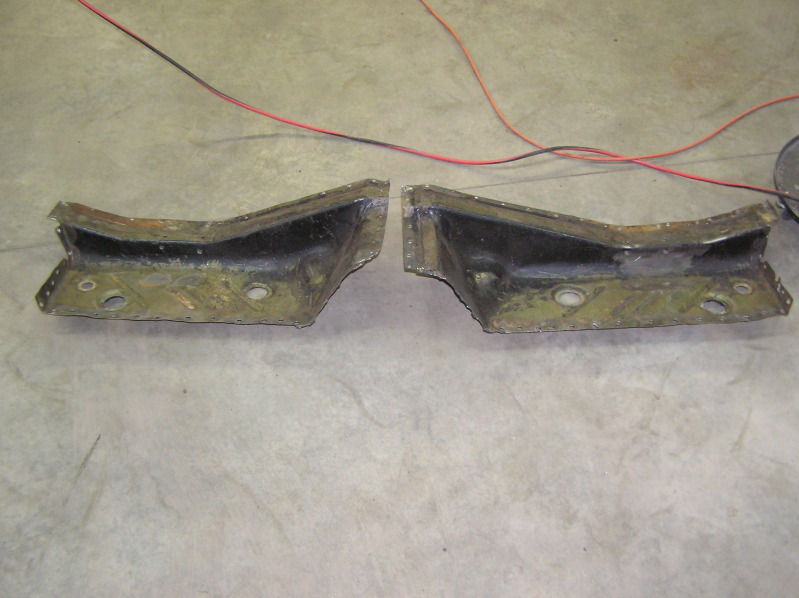

From there I looked up AMD prices and it didn't take long to go over the $3000 mark. (I think it was $3500 total) But AMD's cost for the rear frame rails alone are $800. I paid way less than that for this car. And anything left over (like the entire front clip) I can sell to a fellow enthusiast like all of the members on FBBO!
For me, It's well worth it. Not only am I saving some money, but I am gaining experience taking the car apart. Which will help when I get started on the Charger

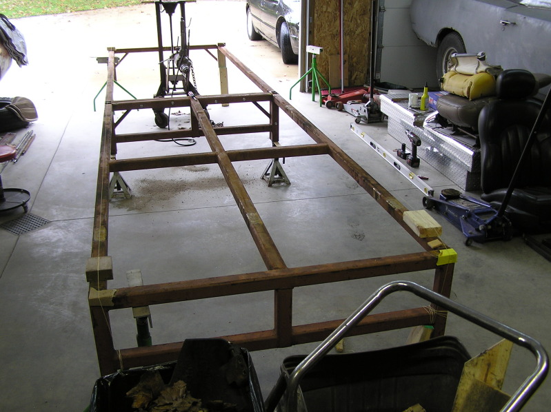

And the frame jig I built for it

About the drilling, I use Blair's spot weld cutter with a spring loaded pilot.
I first hit the area with a wire wheel on a grinder. This helps me find the welds. (If I can see the spot welds I don't do this) Then I center punch and drill with the spot weld cutter. I have to admit on some welds the cutter wants to skip off, usually due to the fact its not a flat area, if I can flatten it with a hammer, that will usually work. If it still stubborn and wants to walk off, I will take a 1/8 drill bit and drill just deep enough for the pilot to grab like a 1/16 deep. this does the trick. I have yet to drill all the way through with a drill bit, then use a spot weld cutter. Hope this helps. (Kudos to propwash for this tip)
