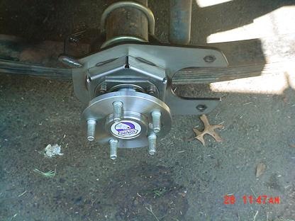

I think I've got the bracket on right, found a pic of it this way on an a-body, but the caliper isn't going to line up with the rotor -
Anyone got a pic of how this is supposed to go?
I'm also not liking the way that brake line is not anywhere near where it has to go. I might be able to get it there, but it will also have to twist down 90 degrees. The other side looks like it will be even more difficult.
There's a fifth hole in the Scarebird bracket, where there is no stud on the axle flange -
Scarebird includes a nut and bolt that look like they could go here. Am I supposed to drill a hole in the axle flange?

O.K., fifth hole on the bottom, not used in my application. I was worried about bearings, but it looks like I'm fine for now. Still not sure about the seals but I haven't had any leaks under my axle so they may be good. I think I can put things back together.

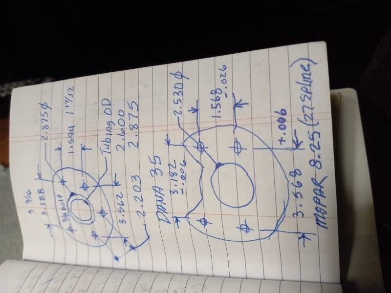

Just as a future reference,
Jeeps' bolt flange pattern
on their D35 is almost
identical to Mopars 8-1/4.
This would allow for a far
greater selection of
available kits to convert.
