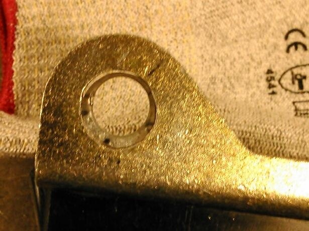

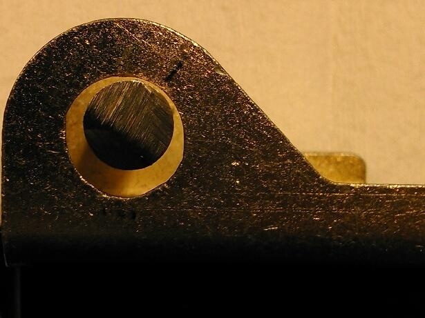

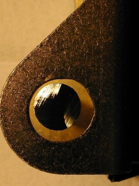

Be aware of the terrible quality of these mounts. The hole for the .5 bolt is .700 and off center! I made a bushing to take up most of the slop. These should have been lasered & CNC bent. Looks like the holes were plasma cut free hand. I would not buy these again!

I cut the head off a bolt to show how bad they were.

Not sure what the opposite side ear looks like on those and I'm not a big fan of Schumacher anyway. But factory B/E body type mounts have a larger hole on one side, with a welded nut on the other. The OEM bolt has a wider head (like a forged in washer) and it goes through the wide hole, through the K-frame, and then into the welded washer. Once the bolt is torqued the size of that hole has no importance. Allowing for proper driveline alignment and easy of assembly does. There is not enough precision in the factory design to allow for a .500" hole for the .500" bolt. so there's some slop built in. Remember these are production line, slammed together cars. Not aircraft.
Depends on your definition of functional, if you mean oversized holes, the bolt not going through the mount parallel to mounting surface then yes they are functional. Again I bought these under the premise that the were better than stock issue, they are not. The problems that anyone can see in the pictures above. Anyone with half a brain should know that things that don't line up put additional stresses in places. Supposedly these are "High Performance" pieces. I interpret that to mean built to a higher standard. Again for the price they ask I would expect more. I should of bought the stock ones for 15$

I have more than half... You're pissed, I get it. My point was you're complaining about something that by design, if it was "better", wouldn't fit 50% of the production chassis out there because they are not that good. As for engineering - the bolt does not have to be parallel. It has to squeeze the ears against the K frame hard enough to hold things in place. In doing so if the ears bend, or the Krame bends a little, it's not considered a problem. It's that simple. By "high performance" they mean the flexible parts don't rip apart. They are not billet machined and made to aerospace tolerances. The area that counts (the "rubber") is made of better stuff. Not to higher standards than the factory stuff. The torque strap was/is a joke too... leas the E-body one. I hope the full-brained types don't fall for that advertising... lol.
