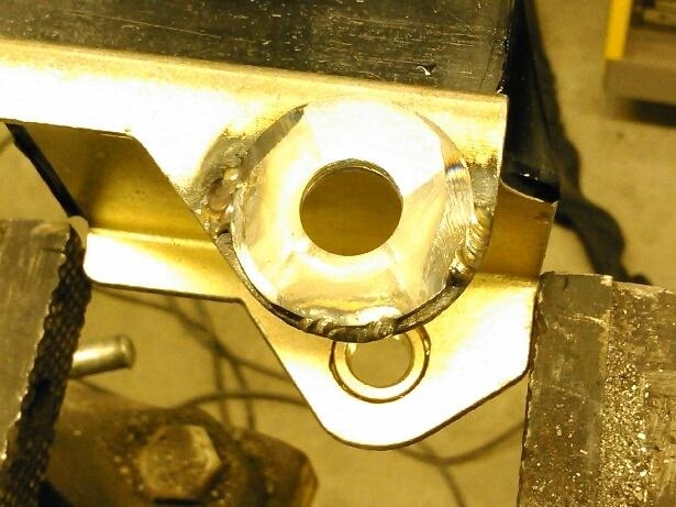

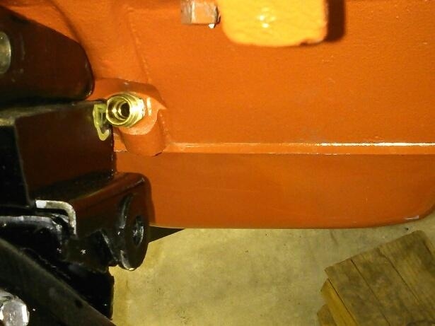

So I used a washer that I tigged on that gave me a hole opening of .56 centered on the bolt. Be sure not to let the heat get to the poly if you do this. This also helps strengthen the ear. I installed the engine over the weekend and had to problem with the tightened tolerance of the hole. Although it was a very snug fit next to the compression fitting on the dipstick.
I made some shims to insert on the sides to take up the extra .124-175 of clearance once the mounts were on the saddles. Should help from deforming the ears when tightening and help take some movement out.
