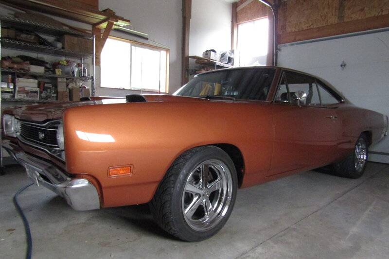

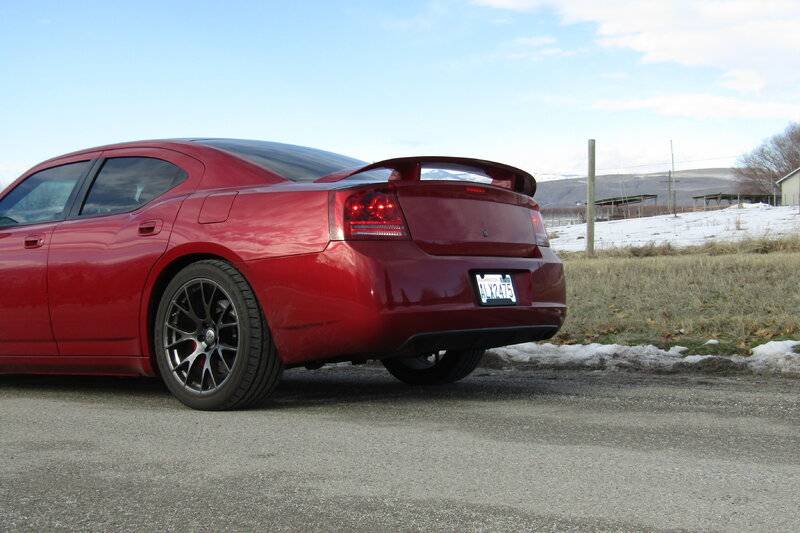

My observations on the issue , I work at a dealership and have road ready prepped several hell cats , red eyes , wide-body's and even a Demon , the power and nice ride is there absolutely , high speed stability is great of course , however the fling ability is lacking due to the weight of these vehicles . Also the rear sub-frame causes weird rear-steer on uneven surfaces , although this can be corrected with poly or solid rear bushings like I used on my own SRT8 . The thing is my 69 Bee with a mix of Bergman , Qa1 , Hotchkis , Bilstien ,Mopar performance , Hellwig and other parts I have selected over the years along with some chassis stiffening and precise alignment angles makes the old car really shine on tight canyon roads and high speed stability on the straights is nice too.
