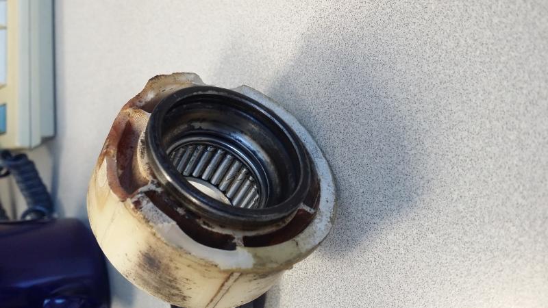

I'm going to make a better system. Something with needle bearings...I've got some ideas and I'll post up my solution. There were no races or ball bearings when I opened the column lol. Just rusty dust!

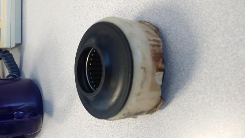

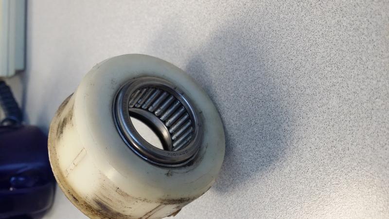

So I got a needle bearing that fit the inner shaft and with a small spacer made it fit into the plastic cage. There isn't any play anymore when I assemble everything. I've also found a seal which I will attach to the back side with a couple of tiny screws. Pack it with grease and all done.
So since my column was plagued with issues while reasembling I realized that this would not work since the inner tube slids into that plastic cup - I managed to ger a needle bearing with a 1" inner and 1 1/4 outer diameter and was able to tap it into position and lock it into place in the inner tube - Bingo! snug as a bug and no slop. Just waiting on parts for final assembly.
