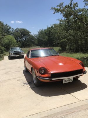

Looking good! What’s the other car? Thought for a second there we had a similar combo.
We've been working on the mechanical a lot lately. I ended up with a QA-1 front suspension including the K-frame. Not the original intent, but that ended up being the best solution. I'm going Pro-touring anyway, so what the hell. Since the QA-1 front sway bar is bigger, I added the 7/8 ADDCO to the rear. I upgraded the rear diff to 3:23 Sure Grip. The original aluminum slots won't clear Wilwood calipers, so just rotors for now. I have the new 17 inch Cragars, but I'm keeping them in the boxes for now so they stay nice.
