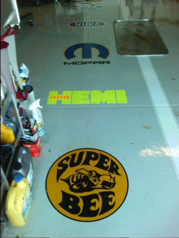

Epoxy is real nice for areas that u aren't going to beat to death but you can damage it easy .My floor is epoxy with a chemical resistant polyurethane clear coat. I installed the custom Mopar Decals after epoxy and before the clear coat ,looks awesome and cleans up easy with a rag ! My buddy makes the custom decals when I can get him too! But there not cheap let me know if u are interested

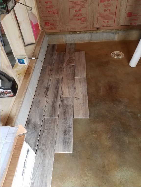

Hard to tell from this picture since it's a small area and isn't sealed yet but this is a piece of my floor that I experimented with stain on. It will be getting tiled (bathroom) but makes it a good testing spot. I like the look so far.
Hell yeah, that looks pretty cool. If you mess around with it, you can always do a texture as well. Put one even coat of stain on, let it dry, then put a second coat on with say a push broom and make arched patterns. When you wash and neutralize everything you'll end up with a subtle design. Good luck!
I'm going for a natural almost stone look, I'm using 2 colors in 2 different sprayers applying both at once so they flow into each other creating a more natural look.... or at least trying.
So if I'm not completely happy I can go back afterwards and hit it again with more stain?
