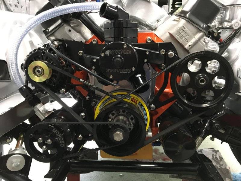

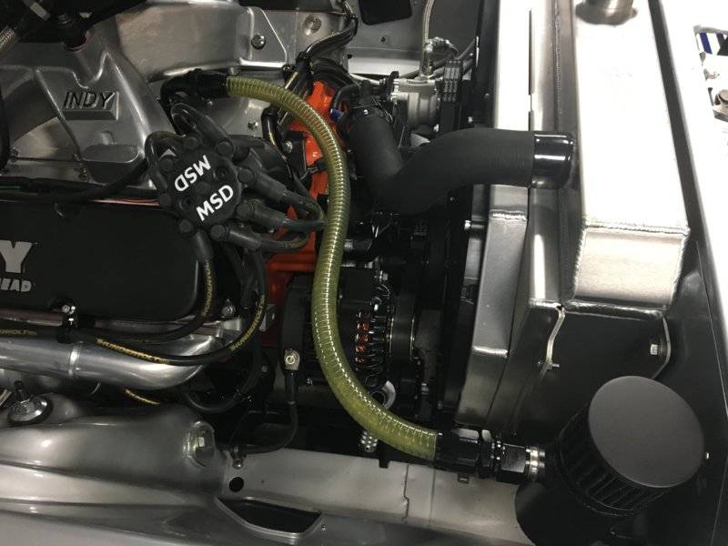

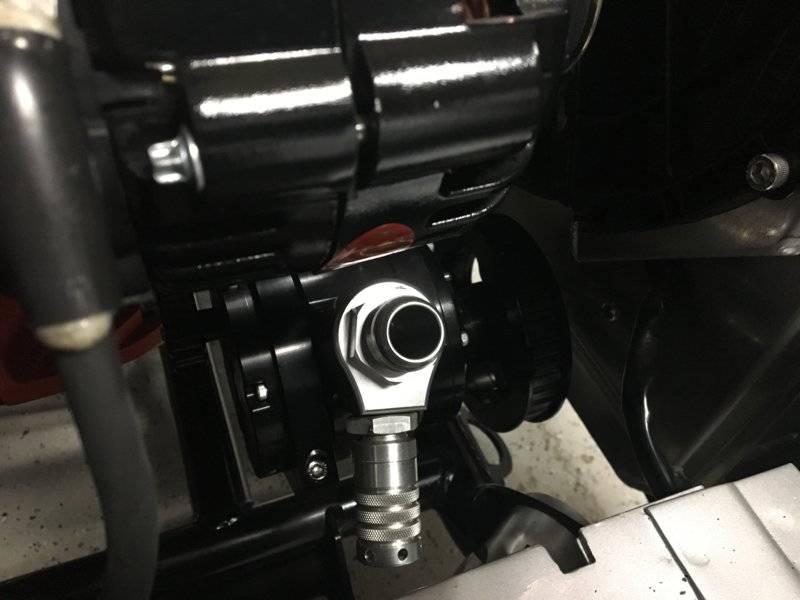

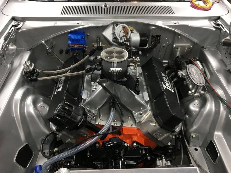

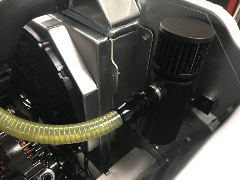

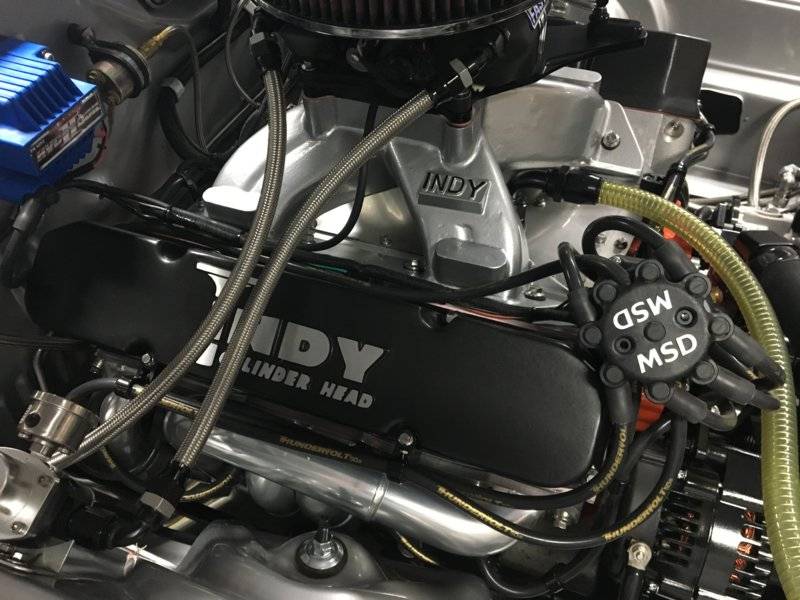

New build 66 Satellite designed to run on Moroso Vacuum pump but couldn't keep it from sucking oil so I abandend it and ran the vent hose from the valley plate directly to the breather oil catch tank. It stoped the oil issue and now I can drive the car but I just thought about it and realized I have no PCV system and the valve covers are sealed. Do you guys think this will hurt the motor overtime?
The Vacuum Pump before I disconnected it and the point in the valley plate I was pulling from.

You don't have a separator on it? Not seeing one in the pic....

Nice looking engine, looks like you've bought a few of the parts I make. It is very, very difficult to pull from the valley area and not get a lot of oil. I've tried that trick a few times and none of them worked. It is much easier to pull a vacuum from the valve cover. Almost everyone pulls from the valve cover and most people are able to make it work. The Indy covers that you are using are tall enough to put a good baffle in there but it takes some fab work to get it correct. You'll want to put the baffle about 1/2 inch from the top of the cover so the vacuum port has room to breathe. The baffle needs to be sealed tight on the sides so oil can't get past. Just leave it open on each end. Make the baffle about five or six inches long.

Definitely a street car and drive it when weather permits. I may go the valve cover route at some point but would love to see some baffle ideas that worked on an INDY Valve cover before I start. What parts are you making (Just Curious)

You need to solve the baffle problem either with the vacuum pump or with a PCV. In both cases you'll be pulling a vacuum on the fitting and if there is oil there then you'll be sucking oil into the engine or into the vacuum pump. I don't think you'll be successful with the valley pan approach unless you copy the old Ford FE method. The Ford FE pulled vacuum from the valley but it took a fairly complex breather setup to work. The valve cover is an easier way to go but you'll still need to modify your valve covers. I use billet valve covers on my engine with a PCV valve. It took some work to get a baffle system that didn't allow oil to be sucked into the engine. The best way to approach it is to copy the factory design.

Yeah - can't pull from the valley like Andy said. There's little reason on a street car to run a vacuum pump. I'd think unless the camshaft is really radical the factory PCV system and breather would be sufficient.
