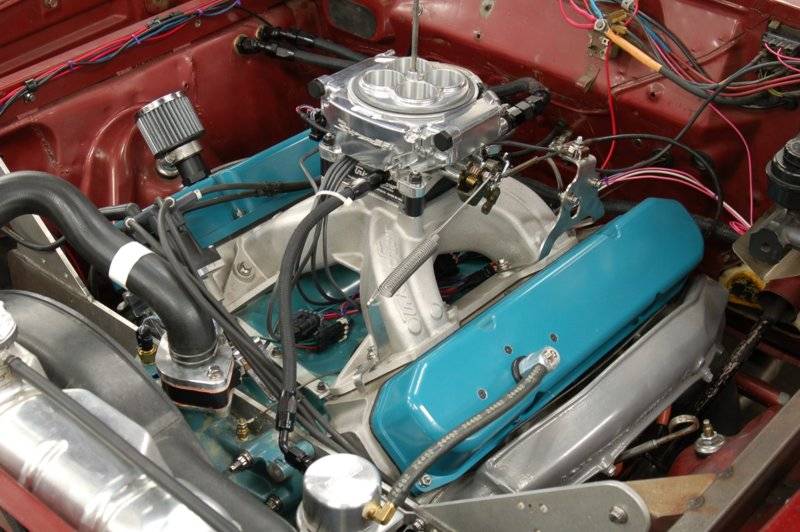

I'll jump in here, since I have similar questions... I run a simple Moroso breather in the VC through a 1/2" hose to the bottom-side of the air filter base. The other VC is sealed. System seems to be fine - vents fumes and pulls a tiny bit of vacuum due to filter resistance, but doesn't seem to affect engine performance. Yes, I get oil in it, but that is due to a complete lack of baffles before the breather, which I am remedying this weekend.
Is there an advantage to putting a PCV into the other VC, and does it go to the 3/8 port at the base of the throttle body?

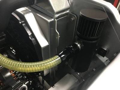

The breather tank is baffled inside and is supposed to accumulate oil in the catch tank, which it does just way to much then spills over and fouls breather.
How much oil is in it after each pass? The vac pump and separator is a racing deal and should be checked often. A buddy of mine ran one on his street legal race car but when just driving around on the street, it didn't accumulate all that much oil unless he made a pass or two. It will accumulate oil mist that's generated from windage and that can fill it up pretty fast. Street engines don't make that much mist unless they are run hard and when they are run hard, you generally do not create enough vacuum to pull oil out through the PCV system. Didn't go back over all the new posts but did you put a gauge on it to see how much vacuum it's pulling at WOT?

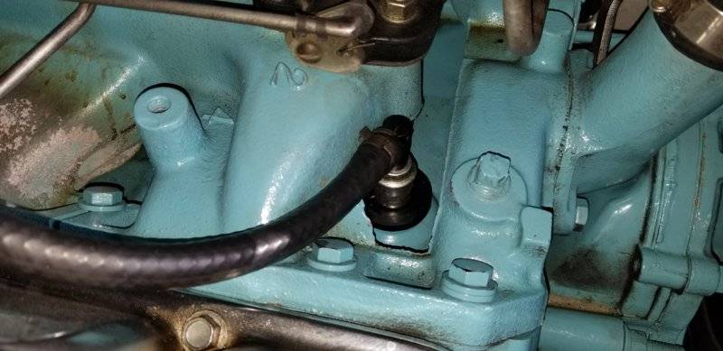

BTW I've never seen someone pull from a Mopar valley pan, but the 421 Tripower is setup that way from the factory, and it works well, BUT the Pontiac valley pan is dual layer, so I think that makes the difference in not picking up oil.
Pic is old PCV valve, M/E Wagner is in the mail!
