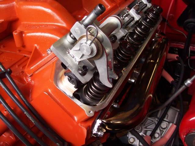

One thing also is headers are much better now then in the 70's as you can see my headers have a nice thick flange and they never leak. Back in the 70's many had thin flanges that would warp and leak. I never have to retighten my header bolts and have no problem with plug wires either. Ron

Its really simple..........the headers will always make your car a little faster but of course are not stock looking. So you just need to decide if you want every bit of power you can get from your eng. If you are not worried about the most power and prefer the manifolds then by all means run the manifolds. If you look at the pic of the header flange thickness in the pic I posted a few post back you will see headers have nice thick flanges now a days and dont leak all the time like in the 70's. In fact since 2006 I have never had one single header gasket leak on my 63 and I do race it some.

Ron,
If you don't mind. What kinda spring compressor is that and where can I get one? Thanks.
