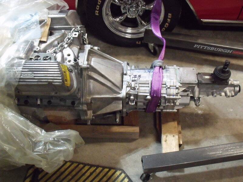

Here is a picture of the TKX that replaces the TKO...
