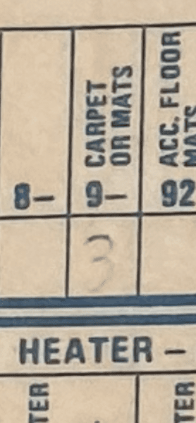

Not on the sheet for '70 Charger. However, carpeting is addressed on Line 6 Sales Code.
Carpet Or Mats 9_: This box was used to identify if carpeting was selected for the car (option code C93). All 1970 Charger 500s came with carpeting and as such this box will always have the value of "3" indicating option code C93 (Carpet).

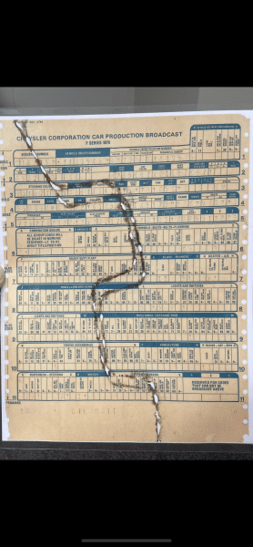

I was wondering about my 70 RR
I see on line 6 that it came with carpet but was wondering what color.
And no I wasn’t GREEN :lol:
I don't have any Mopar factory or dealership books on interiors, but I'd be willing to bet the carpet color was automatically keyed to the interior trim code color.

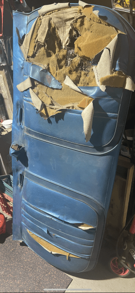

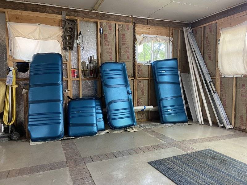

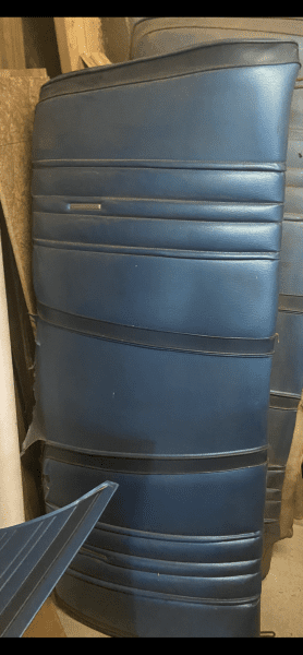

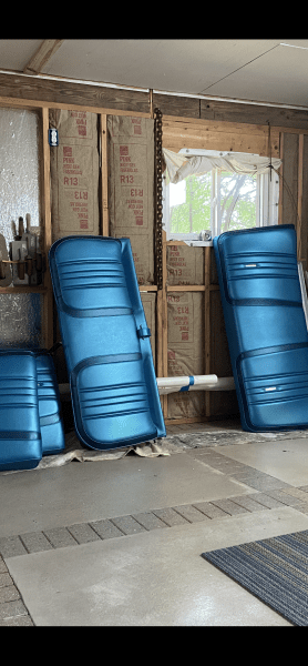

My issue I’m having is I’ve seen both dark blue and light blue in the B7/B5 interior cars. I put the dark blue in and not happy. I need to decide before I put the seat back in. Either color will work but I kinda like the lighter blue. I removed the original carpet when I was drunk. Lol. Now I don’t remember.

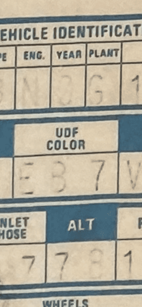

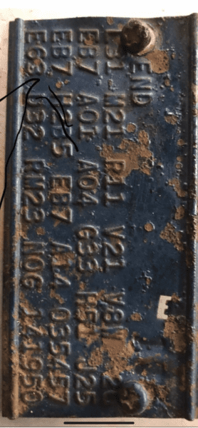

Your car is EB7...dark blue?
What is the UDF color shown on your Broadcast Sheet?
For example:
UDF COLOR:
This code identifies the Upper Door Frame paint color. This is the paint they applied to the inner door panel so it matches or accents the interior trim colors. The options in this field will be one of the following:
EB5 = Bright Blue
EF8 = Dark Green
EW1 = White
FK5 = Burnt Orange
FT6 = Tan
TX9 = Black

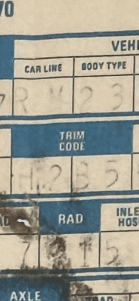

Your Trim Code is H2B5 ?
Go with the lighter blue upholstery than your current upholstery and get the matching light blue carpet...from a quality manufacturer/distributor.
