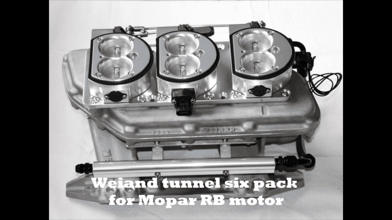

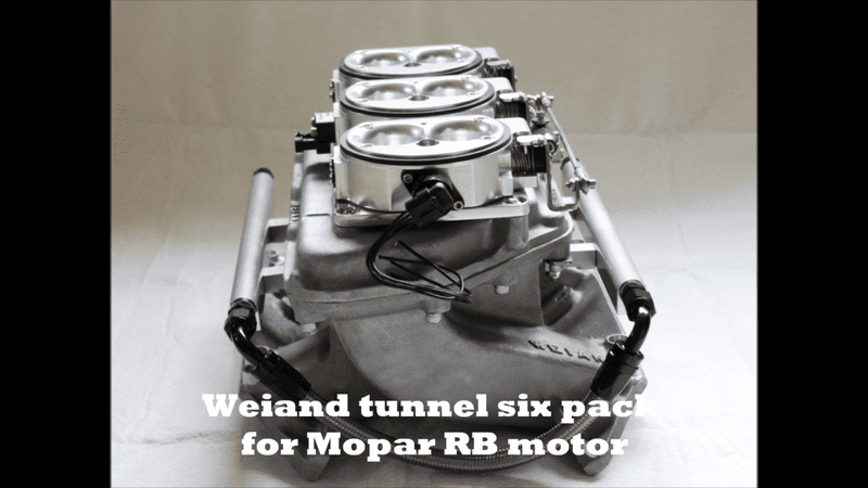

My main point is the F&B 6bbl EFI direct port injection system turns the Weiand into a dry manifold, and that eliminates the main problems that it has: fuel pudding and uneven distribution.
I'd love to use the FiTech 3x2 but it has a hard ceiling of 600 HP and my 541 is slated for more than that.
Here's the F&B system on the Weiand intake:
