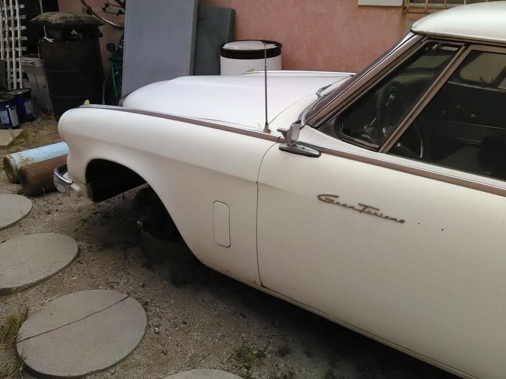

This Studebaker Hawk was painted 35 years ago with PPG Ditzler Delstar acrylic enamel.....it has been sitting outside on stands for well over 10 years in the desert here in so cal without being touched. No checking, not even much chalk from oxidization. I can run a polisher with wool pad, & light compound, followed by foam pad & very sparing light compound & glaze mix on it & bring every bit of can color back out of it. Paint will oxidize but not peel or crack for a very long time. Oxidization in pigment paint starts from top & works down.....once the clear, which IS plastic film, succumbs to UV, it penetrates all the way through, starting by milking it out, then eventually crazes or fractures until it starts to flake & peel. The hood is most often the first panel to knuckle under because not only the heat & UV from top, but also being baked from underneath by engine heat.
