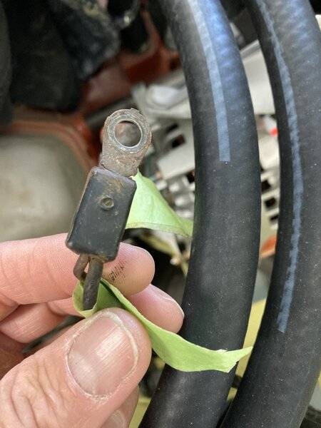

What I did was leave the original alternator wire. I cut the lug off and soldered the purple to the black. That way the horn relay was fed as intended. I then laid the painless wire and taped it into the original harness all the way to the bulkhead area. I mounted the painless fuse block near the bulkhead and wired the alternator harness to it. I then ran power off the battery terminal of the starter relay to the painless fuse block. I also am running a converted ammeter that is now a voltmeter.

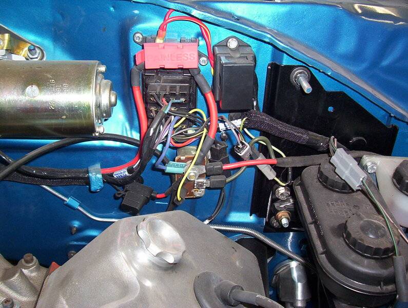

Here is a picture of the wiring at the bulk head.

I converted to a voltmeter. So to answer your question no it would not work. However your car will be a lot happier and safer with it by passed. There are cheap volt meters that can plug into a lighter socket if you want to monitor the system. If your dash is still out find a company that can supply a volt meter.
Thicker wire to reach the amm and offer a better path than the bulkhead. The weakest point is the bulkhead. Once the bulkhead is saved, the rest of the system will be in peace and safe, including the ammeter ( believe it or not ), with a high output alt
