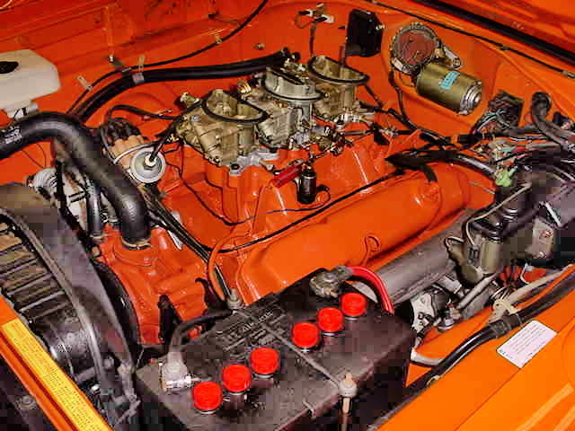

I say if you have the time and patience, get the 6-pack. There's a little more effort involved in tuning 3-2 barrel carbs but any capable mopar mechanic will know how. I must have called 10-12 shops before I found a guy who I could tell was capable and not full of ****.
I've seen many 440 6-packs run in the 11's, none bored to 500 ci.
I have a 440 6-pack, bored 40 over with a mild cam. If memory serves me correctly, torque peaked somewhere around 545 lb/ft and a tad over 500 hp (510 I think). The torque curve on these setups is phenomenally flat too. I've never tracked it though. My hands shake everytime i'm done driving it, so I'm not entirely comfortable on the track. Not sure if its the gas fumes or because I know at any minute this car can break loose and end up in a tree.
Plus, there's no doubt you have a 440 6-pack when you have the lift off hood.
What do you plan on putting this in?

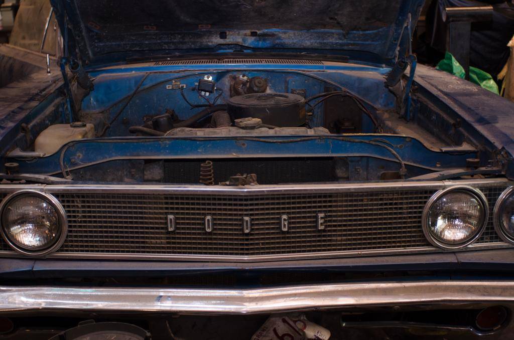

my 68 coronet. was planning on stroking out the motor but was debating the intake setup. when its so easy to get 500 cubes these days, why not? i definitely have the time for it and nothing quite beats it.

fell in love with it. my grandfather and i talked about it, but once i saw it i knew for sure, altho i already knew even when we just talked about it. he offered it to someone else but said if i wanted it hed sell it to me instead. making payments :happy11:

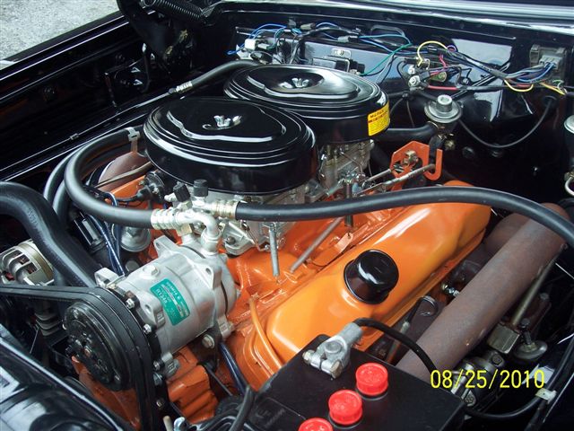

I put a dual quad on my 440 and it runs very strong. I bought the set-up from Mancini Racing.
with the dual quad id prolly be running close to the same cfm out of the carbs, but that six pack look is priceless!
