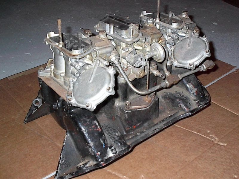

So why is it that a single plane intake does better numbers on the dyno than the 6 pack? Is the intake manifold on the 6 pack restricting, I mean come on, you're flowing 1,350cfm at WOT, and a 950 or 1050cfm 4bbl will give you better numbers?

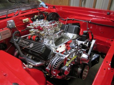

How About Both,Kind of!! 500 Stroker with dual Quad and 6 pack air cleaner.Copy of IMG_1059.jpg
I believe a 6 pak intake would have a broader torque curve. In other words, it would have more torque at 2500 RPM than the single plane. But the single plane would produce more horse power and torque at 5000 RPM than the 6 pak. These are just approximate values to show the different characteristics between the 2 types. The single plane is generally going to make more top end power than a dual plane.
It's actually around 955 cfm for a six pack setup if you convert to the way 4 barrels are flowed.
4 bbl are measured at 1.5hg of vacuum and 2 bbls at 3hg
To convert from one system to another (with a very small percentage of error) is relatively simple. Simply use the square root of 2 (1.414). Thus to convert a two-barrel rating into a four-barrel rating, divide the two-barrel rating by 1.414. To convert the four-barrel rating to a two-barrel rating, multiply the four-barrel rating by 1.414.

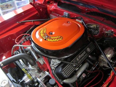

Lets say youre building a 500+ cubic inch stroker motor from a 440, but youre keeping your car pretty authentic in the overall scheme of things, would it hurt the power of the motor too much to do a six pack setup? or would it be comparable with that six pack look still?
We built a 500" RB with a Eddy 6-Pak manifold with XFI EFI. When we spoke with the guys at Indy they said it is about a 60-80hp loss over a single four barrel. The engine made 638hp at 5800. Not to long ago a 505" build used the two four set up and dynode 30hp less than a single four barrel. So from those two I would say two four setup. If you really want the most power a single four is the best option.
