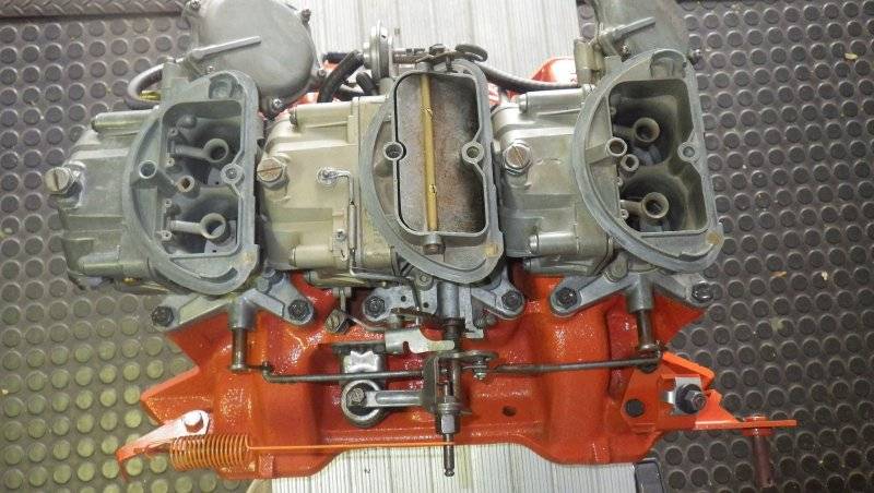

I currently have a 4 barrel on my 70 Charger and I am piecing together a 6 pack setup so i can swap to it easily when i am ready. i have ALMOST everything, just need a couple of parts and springs on the throttle cable linkage.
i have seen the linkage with the kickdown linkage for an automatic transmission, but looking for pictures and or a diagram for the linkage and springs setup for a manual transmission.
THanks in advance.
For a stick, I think all you need is a throttle cable and bracket.

right, so you don't have kickdown linkage.
can you snap a picture?

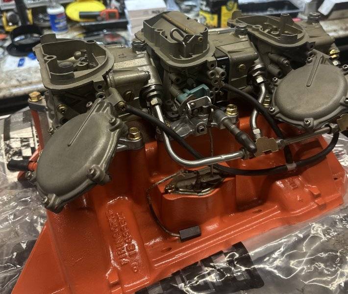

Hopefully, someone else will chime in here, it's not a fast idle solenoid, it's an idle/shut off solenoid. You should be able to live without it, I do. Otherwise, looks like the OP needs a return spring and bracket, air filter and studs and can't see the choke side and fuel lines. Of course, this is only the beginning for getting it tuned!

im not worried about the shut-off solenoid right now or at all.
choke plunger heater is intact but i assume that's hooked to the coil or another keyed power source?

It has an exhaust crossover, and heats the bimetal spring. I blocked mine to gain a few HP and installed a manual choke. Mine don’t have an electric connection.
The outboard carbs have an idle circuit as well. They have lead plugs in them. From the factory they are set lean. The old DC manual suggested backing them off a quarter turn for better off idle response. It works.

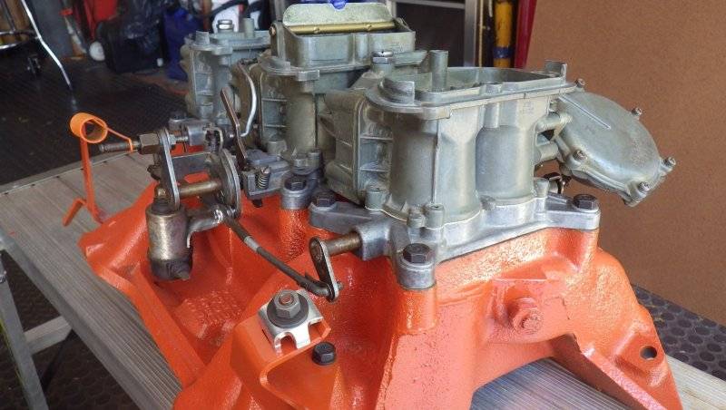

The stud that the throttle cable hooks to is for automatic transmissions. Do you have a short manual trans stud?

i have the same one that Dave69 shows in his picture.
On the car, hooked up as original, running and driving.
