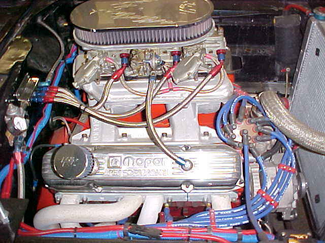

I ran the super stock intake and LOVED IT ! But was a PRO STREET set up for sure !
My 440 was pumping out big #'s but the thing would flat out fly !
Tuned rite when those other two kick in it's like another shot in the *** ! MVC-043S.JPG
Tuned rite when those other two kick in it's like another shot in the *** !View attachment 164318
Did you do the recommended mods in the intake? Looks good!
One thing that hasn't been mentioned is the 6 BBL intake is a divided plenum dual plane type and that also makes a difference. The totally divided plenum is what keeps the stock engine from falling on its face with all those carbs by providing a stronger signal to the venturi. One can simply cut most of the divider out between the two holes and possibly improve the entire RPM range but that would be highly experimental and can possibly ruin the intake. The above Weiand tunnel should do the job very well but is a fuel distribution nightmare. Same goes for the Edelbrock STR.
Yes I did. I weldid aluminum bars in it at the points specified and flow ported the upper side of the base. I had Very good help from a long time racer in York PA who ran super stock for years !
To be honest the thing had good street manners for being a 13.1 motor !!
But it did Shell out a 9" ford rear on me ! Pulled the Pinion rite out the front ! NEVER had any other car do that before !!
And I buld rear's for them all.
Also on your note about the cut the plennume deal. All you need to do is mill a slot (passige) between the two ports at the carb base to equel out the signal. This slot will Balince out the cylinder feed and not hurt the low end pull.
