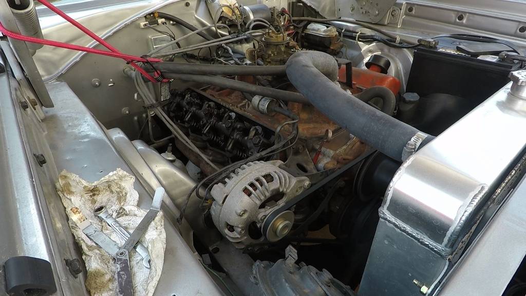

Basic question is this... Why is there sludge on the passenger side of my 1966 Poly Head 318 and none on the driver side?
Here's the background... I set out to do a simple thing yesterday: Stop the exhaust leaks so the wife and I can actually feel comfortable taking the boys out in the Charger without ending up smelling like exhaust. Well, I accomplished that. But, the lack of exhaust noise revealed serious valve train noise. So, I got to rectifying that. That's where the day went wrong.
There seems to be a debate on what the correct valve lash should be for the poly 318. I first set the valve lash to 0.008 intake / 0.012 exhaust after finding that recommendation online. Hmph. That setting was working great on the driver side and really seamed to quiet the poly down. But, as I removed the valve cover from the passenger side, I noticed sludge. I said to myself, wait... I didn't see sludge on the driver side. And I went about setting the lash on the passenger side while I pondered what could have caused the sludge.
Anyway, as I adjusted the passenger side, the engine ran progressively worse. When I started out with the adjustments, all I needed to do to start the engine was reach in and bump the ignition. But, by the time I was done, I was climbing in and playing around with the gas every time. And... The engine sounded like complete garbage when I did finally get it to run again. "It must be down two or three cylinders (more)" is what I thought.
That caused me to second guess the 0.008i/0.012e recommendations. So, I did more checking... I found three other recommendations: 0.010i/0.018e; 0.012i/0.022e; & 0.028i/0.032e. GRR. I chose to go through the whole valvetrain again with a larger gap to see what would happen. As expected, the valvetrain noise returned. However... I didn't get my cylinders back.
So... Without getting into the engine, I wonder what's going on in there. Did I bend pushrods? Do I have "burned valves?" Is there just too much garbage built up on the valves causing them not to seat? Is there too much blowby on the passenger side that's causing the sludge in the valvetrain?
I may need to disclose a few things. The 318 Poly I have been using for the past couple years was plucked straight from the junkyard. I did not pull it apart. I only flushed the cooling passages, changed the oil, poured a bit of oil down each spark plug hole and cranked and pumped the ol' Stromberg 2-barrell until it started. (I know... Poor Poly :( ) As you can imagine, it has Never run correctly. But I considered myself lucky to have a full 6 or 7 of the 8 available cylinders. Yeah. It was that bad at first. But, remarkably, it got better with time. I did take the time to take compression readings on all cylinders before I tried to crank it and then again after I ran it for a while. The initial compression readings told me that there was a reason I only had 6 or 7 cylinders. One cylinder had absolutely zero compression, another cylinder had only 80 psi and the other six hovered between 125 and 140 psi. I adjusted the valve lash at that time and was able to successfully bring the cylinder with zero pressure to somewhere closer to 80 psi. Also, the one that started out around 80 psi was raised to about 120 psi. Although the compression was better the second time I took the measurements, it never did completely even out across all 8 cylinders. The worst cylinder measured around 110 psi and the best cyl was around 150 psi.
Before I "fixed" it this weekend, the engine fooled people into thinking it had a hot cam (though it was hard to hear through the exhaust leaks and valvetrain noise). Now, it's easy to tell that it's just a terrible sounding engine.

Sludge? Poor crank case ventilation! Your blowing past the rings a bit or you've got a slight internal moisture problem from an inadequet PCV valve.
Yatzee, thank you. This is definitely helpful since (as Oldbee pointed out) the PCV valve is on that side. It definitely rattles to beat the band when the car is running, so I think it's working. However, I can only wonder what the rings and head gasket look like. What's strange on this motor is that it barely smokes, even though I cleaned a ton of hard plastic from valve guide seals out of both heads.

Are you getting a good oil supply to that side of the engine?
It's got great oil pressure. But, honestly, I'm not sure I have enough oil flowing anywhere in that engine. I expected to get oil all over the place while running the engine without the valve covers in place. But, to my surprise, nothing spilled out. Nothing squirted anywhere. No mess was made.
I kind of notice that. I'm no 318 xpert but you can't do that with a 440!
Also I noticed that your engine is running in your pictures. I've had a few sludged up engines that I would remove the rocker shafts, some penetrating oil down the oil passage and useing an old speedometer cable or wire, get the passage opened up again.
I've also used Rislone oil treatment to loosen things up but if the sludge is the only thing holding things together, you'll end up with a real noisy engine or worse.
Yeah... I actually shot a few videos with the gopro of me adjusting the valve lash. Then, I snagged these shots from the videos. I haven't posted the videos because I was doing things a little unconventionally. I remember reading in the manual that the valve lash should be adjusted while the engine is running... So I did. But it was near impossible. So, there was a lot of starting, feeling, stopping, adjusting, starting, feeling, etc. Somehow, it felt wrong.

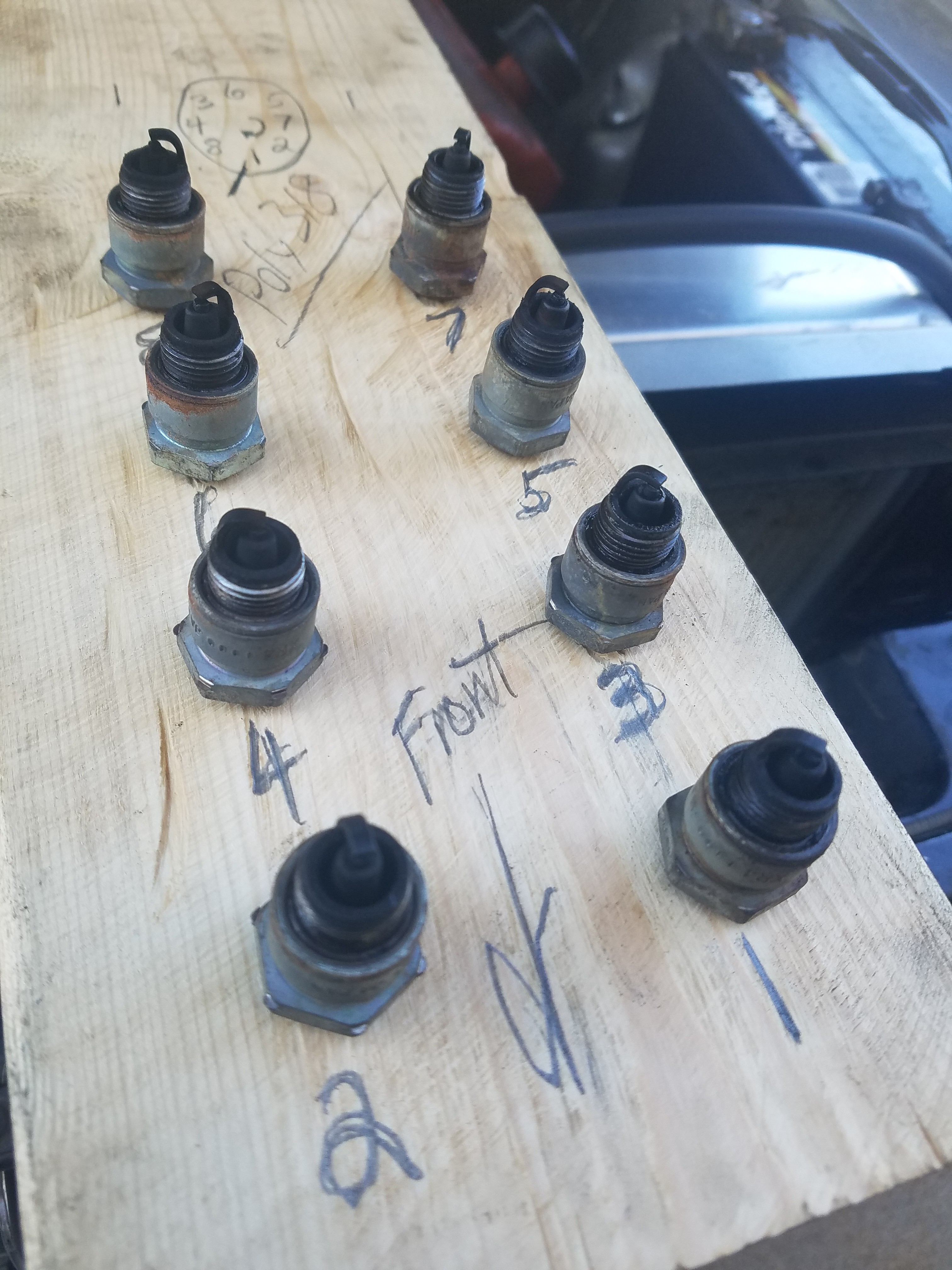

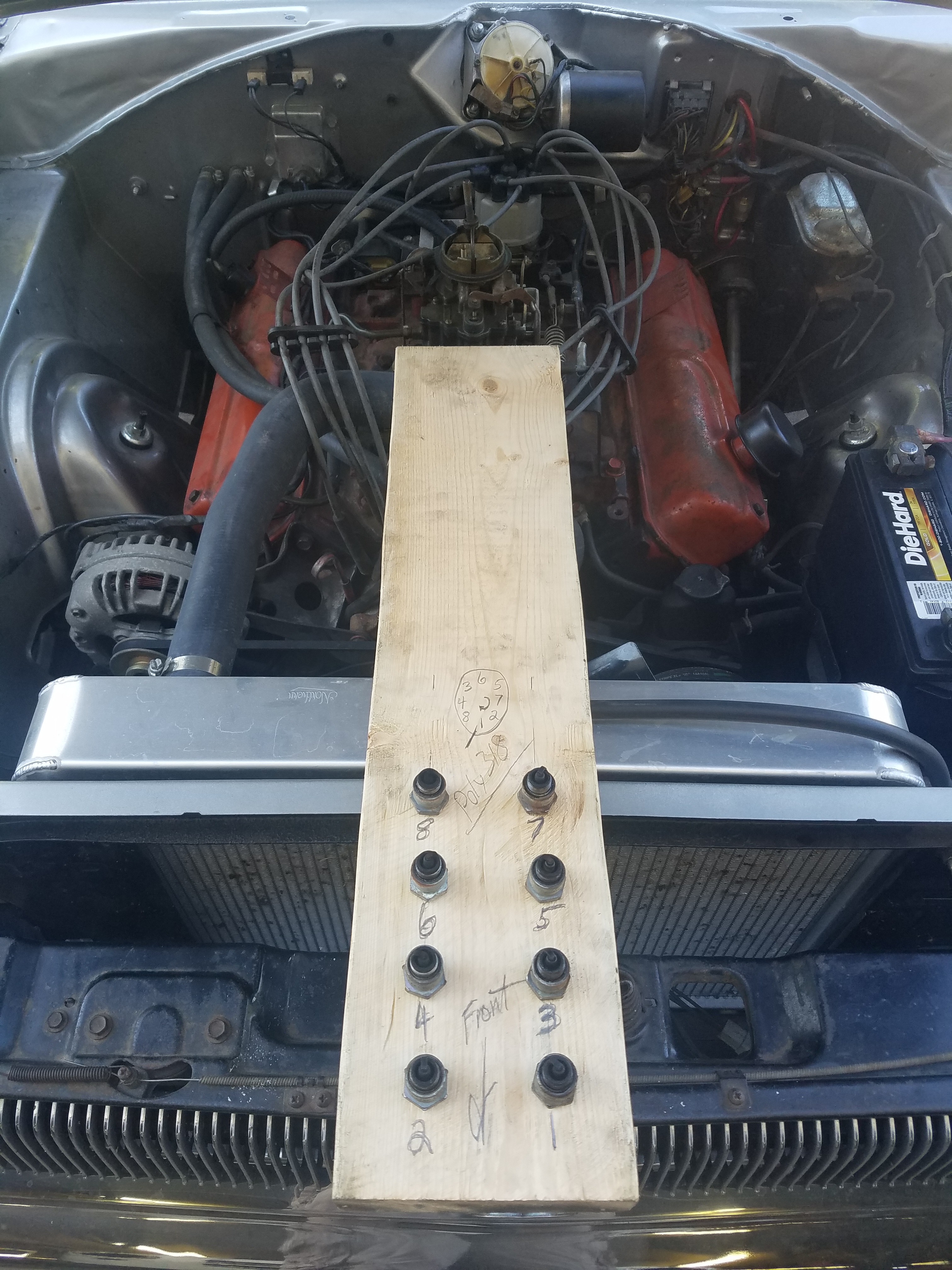

I started off doing something that I have meant to do for so many years that it's embarrassing. I finally made a spark plug holder so I could clearly see what each cylinder was doing. No biggie here... Took a scrap 2x6 that was lying around and drilled some holes. A lot of people just use an old shoe box by making holes for each spark plug with a knife. Same principle here... Just seems more permanent. ...maybe. :)
I used the space at the top of the board to add the firing order so I don't have to look it up each time. Man, my carburetor looks TINY compared to the 2x6!
Anyway... I did a compression test on each cylinder next.
8 150 7 142
6 135 5 150
4 150 3 0
2 155 1 144
Yup... Cyl #3 had no compression!

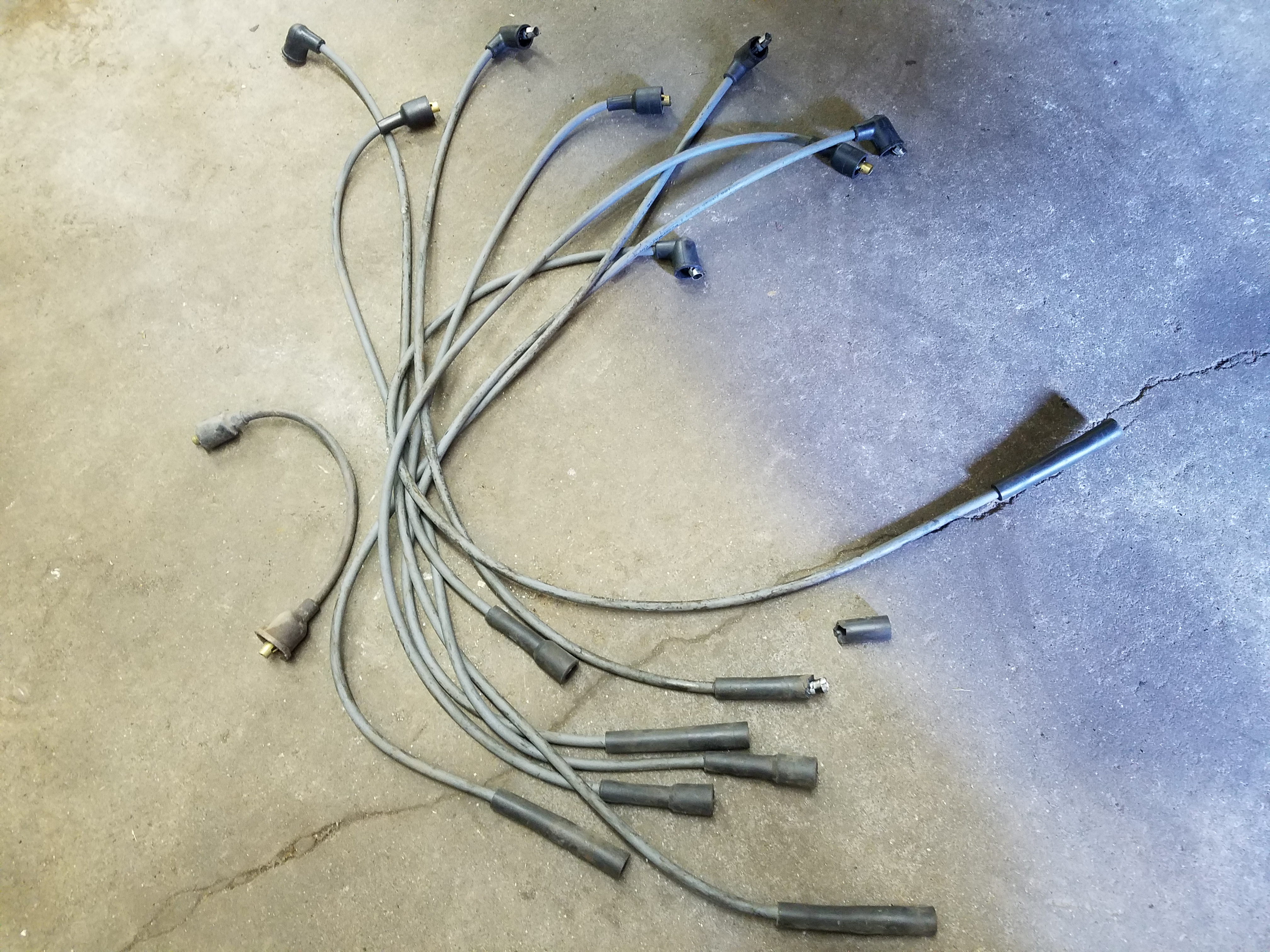

Now... I had a small problem when it came to putting the plug wires back on because the wire boot tore off on the #3 cylinder (again, with problems on #3). So, I pulled a spare set of wires I had boxed up from another engine and started swapping cables. I realized that the "spare" cables (spare is code word for "used" in this case) were easier to work with than the ones I had on the engine. The boots actually slid back the way they need to in order to get the ends seated on the plugs and in the cap where they barely slid on the other wires. It was actually a pleasant experience where I dreaded touching the plug wires before.
Bad wires!
