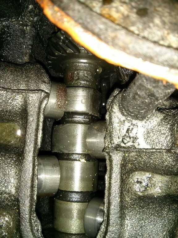

I wonder about the 7.8" that were in the engine and if they could have caused the camshafr and lifter damage shown in the photo.

That's not a pretty picture. Looks like lots of metal shavings.
