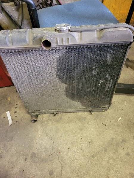

Hey guys, been a while since I’ve posted anything on here. I am getting close to being able to put my engine together and get it in my 67 Belvedere. I’m swapping out the 318 with a 440. My question is on radiator swapping. What are y’all’s Suggestions on what I should do? Do I run the small block that I have or switch to something else? My engine is not a race machine but rather a mild street build, maybe 400 horses. Is there an alternative? Since this is my first build I just don’t want to make any more mistakes than I have already . Any tips or suggestions would be greatly appreciated.

Of course, you old radiator may not be optimal for cooling
the big block engine. New aluminum big block 3 or 4 rows
can be found usually for around $150. I have used them on
several of my cars with good success and I live in Nevada where
it is HOT!
Ran a 22" small block rad in the Bee for probably 35 years. Only actual difference between it and the correct big block radiator is the lower outlet spigot is a size smaller than a big block pump inlet hose. RTV and 2 worm clamps.. never a leak.

I've done this with a couple of rads and I am running Hemis. What I did I took the small block rad to a rad shop and it was a 2 core, And the top and bottom tank has provisions to make it a 3 Core. So that is what I did and I have no issues with heat
