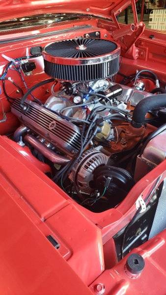

I am observing on days that are >100F degrees with my Vintage Air on and idling in drive at long traffic lights the coolant climbs to 205F QUICKLY! Shifting to Neutral will drop it to 200F. Driving/moving I stay around 190F.
My set up is a Modine aftermarket factory style radiator, shroud, and direct drive fan. It sort of looks like a flex fan set up.

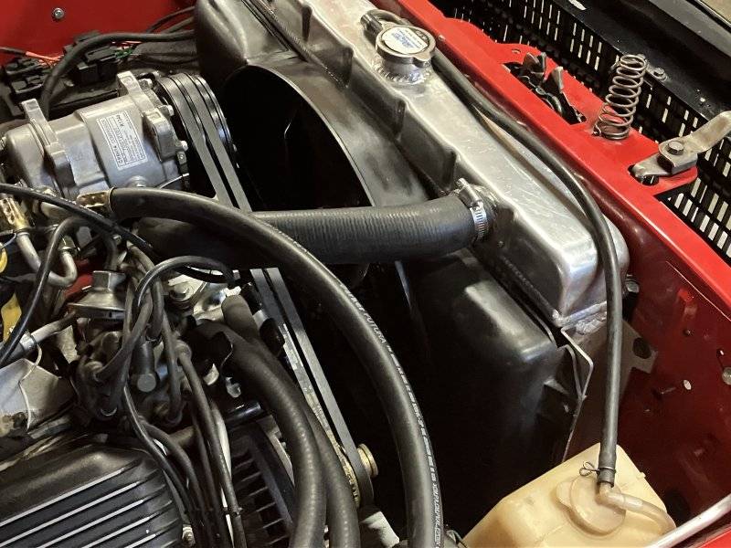

This is my Cold Case leaks between the filler neck & radiator tank contacted CC sent pictures when they found out I was in Australia they disappeared I will have to have the filler neck tig welded to the tank to stop the leak I have 3 x CC only one that leaks
