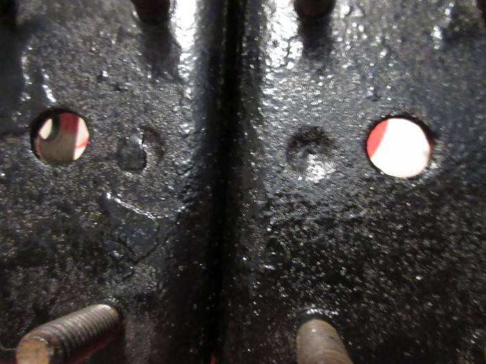

Back on the hangers, only one has the raised area on the side, and they've got these little dimples on opposite sides of the center hole. They're not the same part, and it looks like the differences might mean one goes on one side and the other goes on the other side. I can't imagine why that would be, unless the springs are different, but the springs appear to be the same part for each side.
