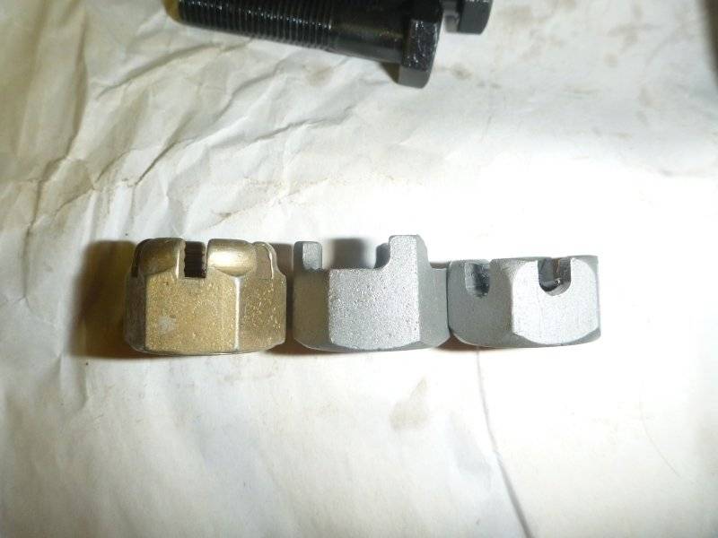

Ahh I see. Sounds like the nut is too short.
And yes the centerlink is correct.

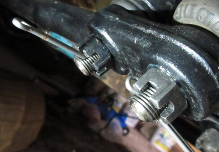

Pic of the nuts that are past the cotterpin holes?

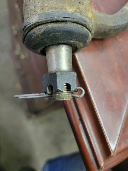

Maybe the best way to identify the tie rod ends is to ask which direction the adjustor sleeve should be turned to increase/decrease the length of the link? Of course this will depend on whether one is facing the front or back of the car. It looks like it would typically be done from the rear facing forward, so should turning the tie rod up lengthen or shorten the link?

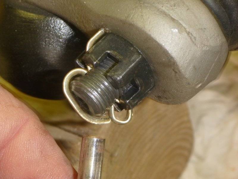

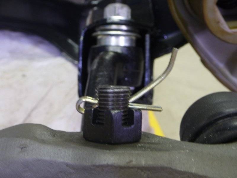

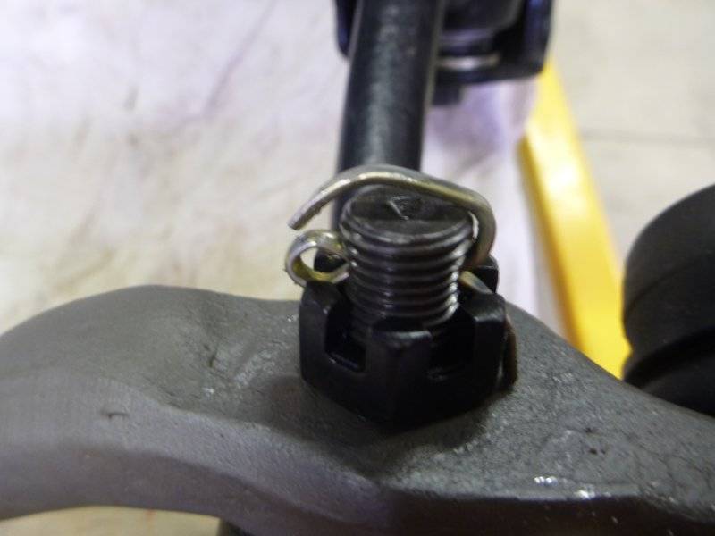

I have run into that as well. Our Ace Hardware has some nice grade 8 smaller diameter thick washers that work perfect as a spacer.Went to torque down all the nuts along the center link, and couldn't get to 40 ft/lbs before the castle nut was past the point where the prongs would catch the cotter pin. I suppose lining the nuts up with the cotter pin holes is fine?

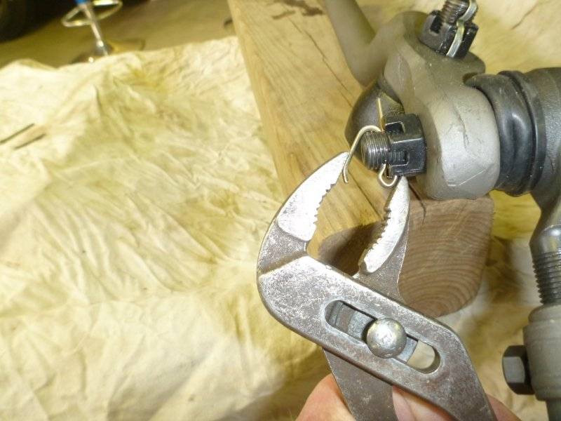

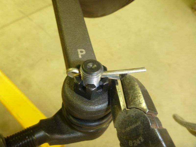

Ok so what's the problem here?

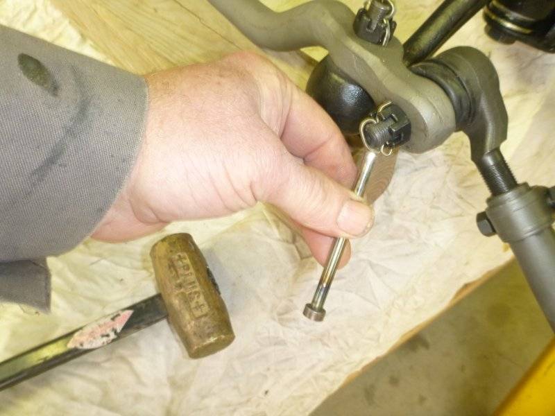

If it looks like this you're fine, slightly pound in the round part of the pin and bend the other side upwards.The cotter pin that isn't in is the same size as the one in the tie rod end. The hole in the idler arm ball joint is 70-80% below the short aftermarket nut. The problem can be fixed by either using a washer under the aftermarket nut or using one of the taller factory nuts.
