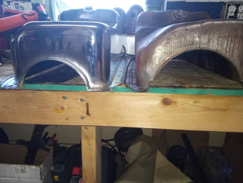

I ordered a new oil pan from Speedway Motors. Chrome isn't exactly my style but I was broke (still am!) and it was $58.
Came in a few days. Did my first YouTube video in it.
Put it back in the box.
This morning was installation time... It's for a 360 not a 318 like the box sez.
Costs $10 to return it. Id exchange it but I'm afraid I'd get the wrong part again. Box was labeled correct...
I'll call customer no service Monday...

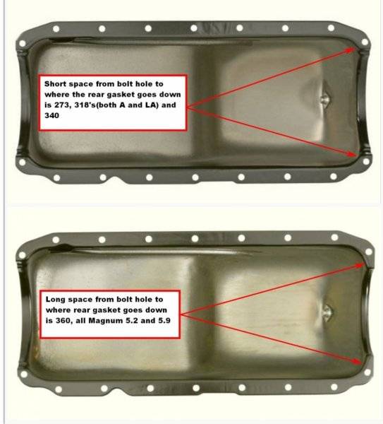

Ok....oil pan quiz.
Which pan is 273-318-340
Which pan is 360?

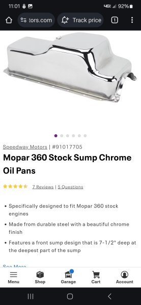

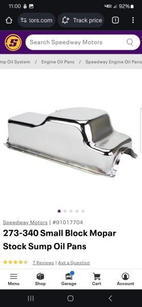

Speedway shows both. I would have them open two boxes and verify if they had one mispacked.
I believe they have them in the wrong boxes.
The photos from the catalog listings are incorrect, too.
I have a "704" box with a "705" pan. The 273-340 has the larger radius for the larger main cap. Speedway sent the smaller pan.
Are you sure about that? I thought the 360 pan had the larger radius, because of the larger crank journals.
According to Speedway both pans are the same!
I'm going to do a video on my YouTube channel to show the differences.
Perhaps some members here could affirm my contention that they ARE different.
