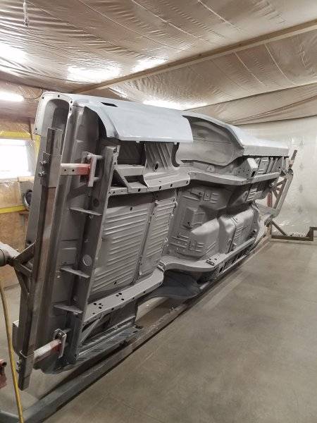

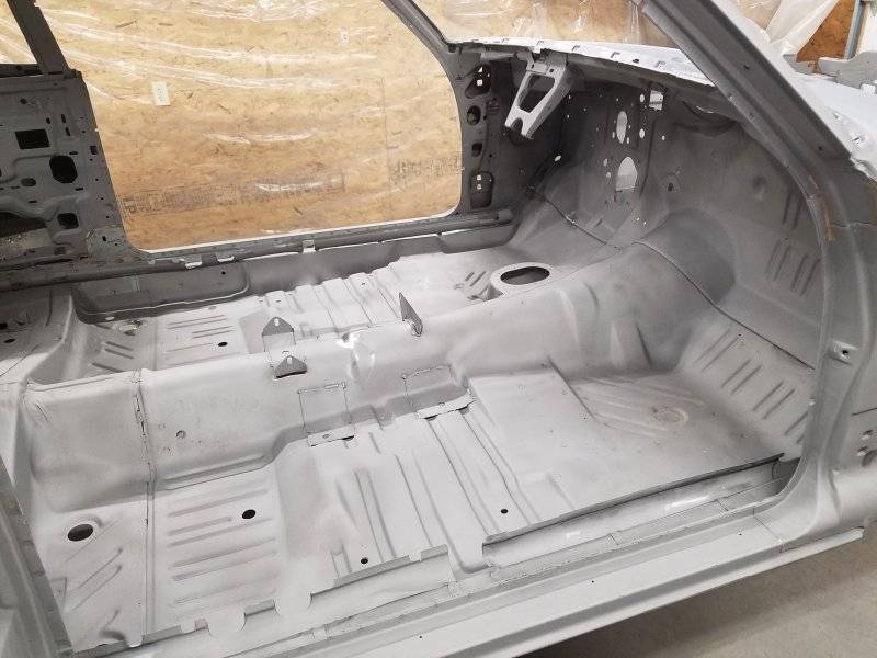

Nasty stuff to say the least! Not sure dry media blasting is much better though. I had my 68 Charger media blasted back in 2014. They used pecan shells on the larger body parts and sand on the underside and jambs. I spent the better part of 3 days with compressed air and a rotisserie blowing that media out of all the nooks and crannies. Even after the car has been back together and driven 20 K miles, I still find evidence of media on the floor of my shop from time to time. I guess the good thing is the fact it is coming out and not caked in until rust creates a hole for it to get out.

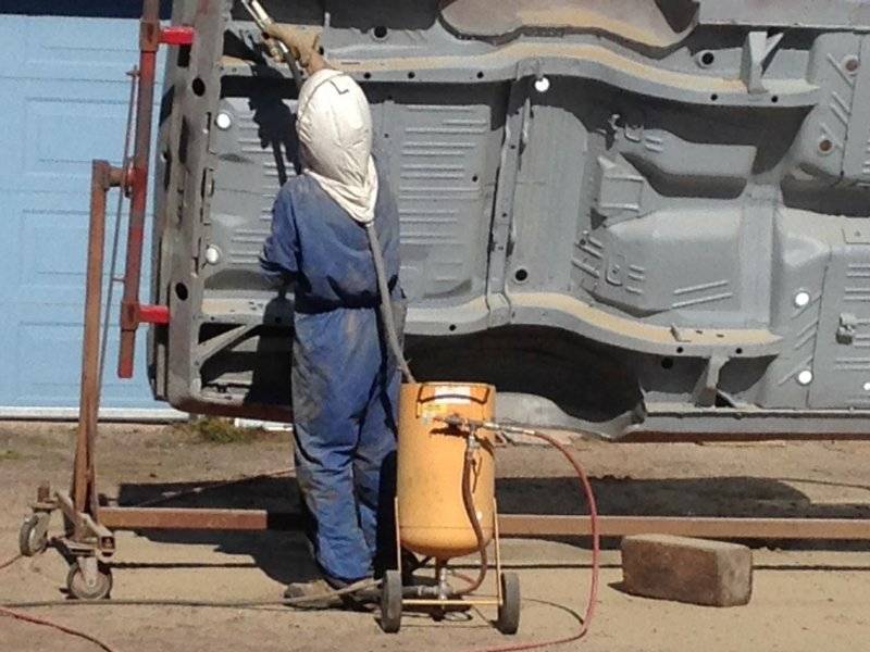

I'm pretty sure soda won't do the trick. We used good old sand on the underside and the inside of the trunk engine bay interior. Any place where there was support seams and ribbing right. All the section that were made for strength. Just small sections at a time so as to not build up heat. Keep moving the tip. Jump from spot to spot often. Yes one hell of a mess. Sand every where. It took a couple of weeks for Roger to do mine. Blast, clean off, and epoxy. And repeat. I'm glad he did it. I wouldn't have wanted to let some one I didn't know or trust. He's 69 and have been at it all his life. 66 at the time of blasting. It's a lot of work to do it right. All the exterior panels were stripped the old fashion way.

Neither soda or media blasting will remove rust. Sand will though and is what I use. You just can't do any flat panels with it because the heat will cause warpage. I DA those areas.

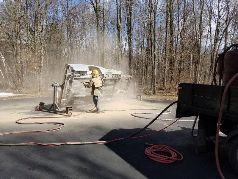

I don't have a dog in this fight but I will state that dry blasting does not cause heat induced warpage. It is an old wives tale. Try it yourself - blast a panel and then put your hand on it, it'll be cool as a cucumber. Heat from welding, a torch or excessive grinding will absolutely warp a panel, but blasting moves too much air across the surface for it to ever get hot enough to affect the metal.
Soooo...what does cause the quarter panel to get all friendly and wave back at you ?
Percussion.
Think about it this way - when you get a dent in a fender say, the metal is stretched and now a bit thinner in that area. In order to remove the dent, you can't simply pound it back to where it came from, you have to "shrink" the metal back to it's pre-stretched state. If you just pound away with a body hammer, you actually make the problem worse by stretching the metal even further.
This is what happens with dry blasting by an inexperienced person. The media acts as thousands of tiny hammers pummeling the metal as you go, thereby stretching it and inducing the warpage. Always ? No. Someone that knows his trade can absolutely dry blast without warping the beejesus out of a car (dialing in the pressure, media, angle of attack etc.). Experience here is the key. But most blasters are used to doing bulldozers and water tanks made out of 1/4" plate and hence the bad rap.
