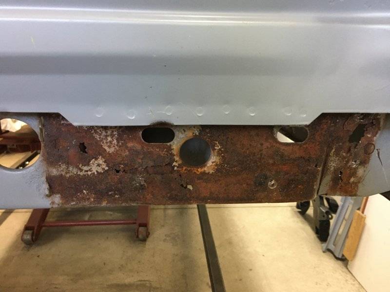

By the way. Think "dipping" is the answer? Guess again !! The car in the photo was dipped and looked awesome. Then while working at the back I noticed some spots that had rusted through requiring a new rear crossmember. This is what was residing under the rear crossmember reinforcements
