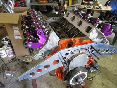

In 59 years I have just shy of 300,000 miles on my Crower solid lifter roller tappets. The only things I wear out are an occasional pushrod (adjuster) end.

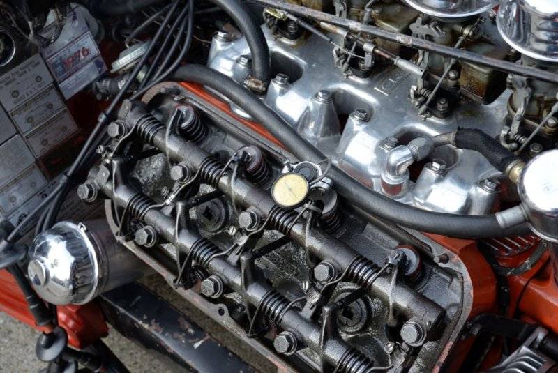

I run a Milodon super rev kit assembly to keep constant tension on the valvetrain so that the only slack is between the valve stem and the rocker arm. It worked just fine on our AA/FD back in the sixties and it's been a life saver on my hemi hot rod.
Occasionally, one of the chromemoly rings holding the rocker arm up off the valve stem will break and I'll immediately eat up a pushrod but they're super easy to replace on the side of the interstate so it's no big deal.
I broke a rev kit spring back in 2014 and that was a bit more work to change but I have spares, so.........
