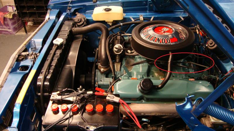

the carb linkage is pretty easy to adjust; unhook the cotter pin, slide the end off, and turn it towards you (righty-tighty) (so the arm moves back towards the firewall) do it little by little until it touches the knob coming off the carb with no/or little slop.
this is a pic of where the carb linkage is (440 cubic inch)....
