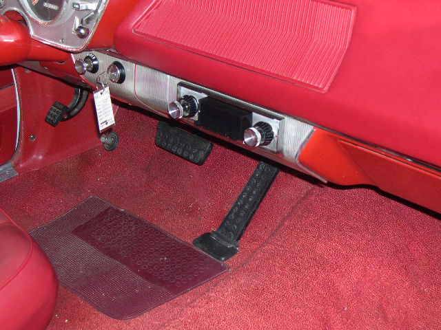

Some have their preference to keep things in the dash looking totally original, somewhat, or no issue. I went the middle route being able to go back to original if that would be a later choice. I chose a Hermosa retro and modified an extra radio plate I had to fit and made up an aluminum insert to get the appearance (in the photo). It also was shaft-mount I needed to avoid more rigging. The radio has a lot of features I didn't need or use but wanted the flash drive feature for tunes not needing CD's and a power antenna connection so I could add that. I put two speakers in the rear panels again reversible by keeping the inserts I cut out and new upholstery that is easy to do on those panels. My car is a drop top and 3" exhaust/headers so yeah the volume has to be cranked some when cruising but dyno-matting helped a bit.
