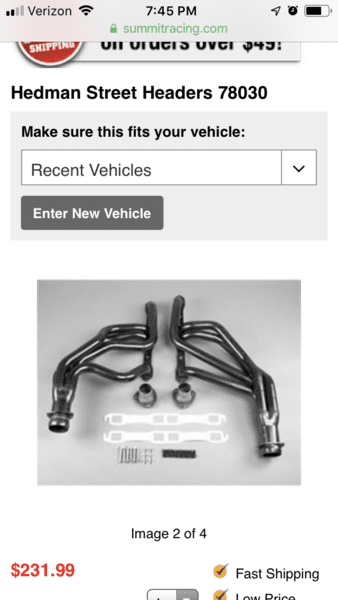

Thanks. I’m still “on the fence” about buying hp manifolds vs headers. The Taylor wires came in and are nice, 6 90 and 2 45. Im worried about header interference as well. Attached is a pic of the Hedmans I’m looking at. Looks like only plugs 5 and 6 might be tight?
Ding 'em if you have to! (We've all done it!) Sucks to beat on new headers but sometimes ya gotta..

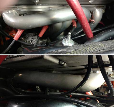

I am running Indy SR heads with TTI 1 7/8 headers. I also have a later model K frame which sets the engine back a little. I have Firecore wires I ordered from Rick with the specs of my setup. All wires have 45 degree boots. I just checked my car and I could have gotten away with maybe 4 90's (1,3,2,4) but not on the rest. The 45's aim the wires away from the headers and I don't have any charred or burnt wires so they must work OK. My picture shows both sides but the passenger side pic is useless.
Looks good thanks for the pics! I can see how 90s would interfere there.
