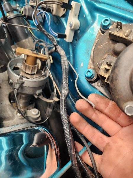

Got a 71 satellite 318 trying to get running right need some help, now I have no spark some times it will have spark and fire other times it has no spark but I've never had it really running good, most ive had it going was able to run for 30 seconds if i kept my hand on the throttle.today I noticed this Grey wire coming off my harness for my electronic ignition not hooked to anything where could it have gone? Also checked my voltage at the coil its only at about 5-6v any help is appreciated

Harness is new,I just cleaned the bulkhead resistor is new,I did find another wire not connected to anything its blue and has 11v to it with the key on I have 11v coming from the blue wire on the resistor and 5 from the brown when key is on

That floating blue wire might be for connection of the fast idle solenoid on the carburettor.
It should have a plastic housing on it.
If the harness is new, can you give us the Part Number please?
