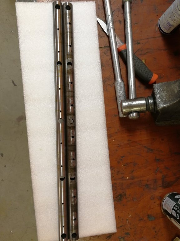

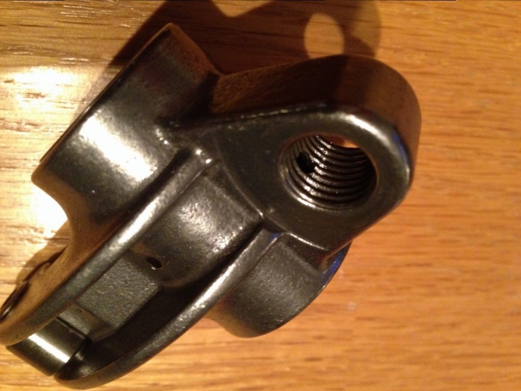

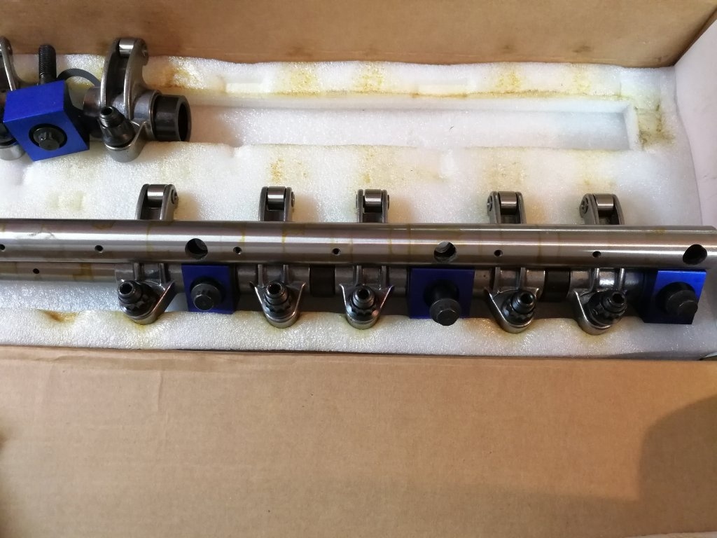

Im in the process of putting these on my 440.
The rockers seems to be ok, but the shafts is another story.
Will probably use my stock shafts.
The oiling holes are way off, at the same angle as the bolt holes and smaller than the holes in the stock shafts.
Wow! I think a call to the manufacturer or dealer is in order...
There is nothing wrong with the hole size or location with that style of rocker arm. The offset hole is for the factory style stamped steel rocker.
So they are, very sorry I missed that. You are correct the shafts are not drilled correctly.
