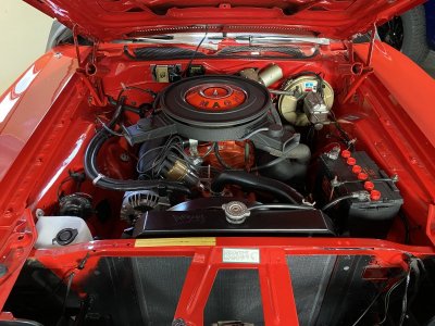

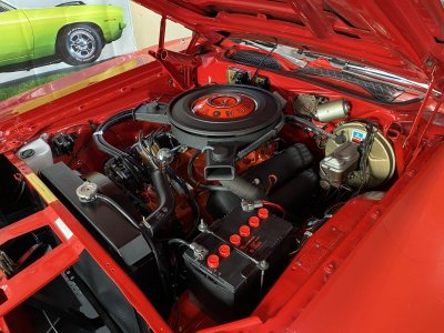

71 Superbee 383 Magnum factory 22" Radiator Support
No Air - Factory 3:23 Sure Grip
Not all big blocks on a 71 Charger came with a 26" Radiator
Air conditioning cars had 26"
High performance rear axle cars / Track Pack cars had 26" etc.
3:55-3:91 / 3:54-4:10
I run this 22" Radiator on my 71 Superbee 383/432 Stroker 500 HP - Now running a 3:91 Rear Axle also
Fit perfect - Factory fan shroud fit perfect
Yes very expensive
However when I bought mine they where running a sale around Black Friday and free shipping , and of course around 4 years ago - 1.25" Cooling tubes and Auto Trans
Whole thing was under $500
https://wizardcooling.com/1970-1973-22-mopar-applications-aluminum-radiator/
Yes very expensive
