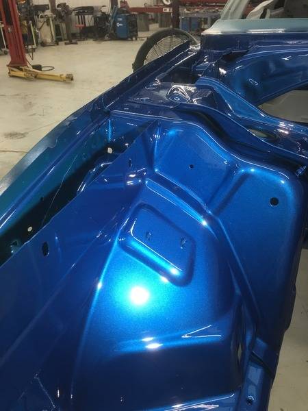

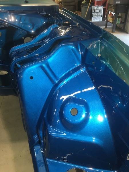

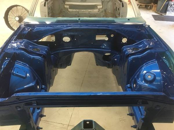

Thanks again guys for the kind words. Got most of the engine bodywork done. Not going crazy. want spot welds to show and panels wavy. Want it to look like a production vehicle.
Will paint Saturday and post pics.

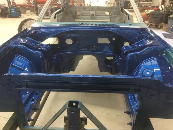

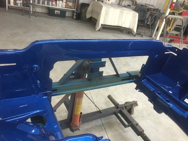

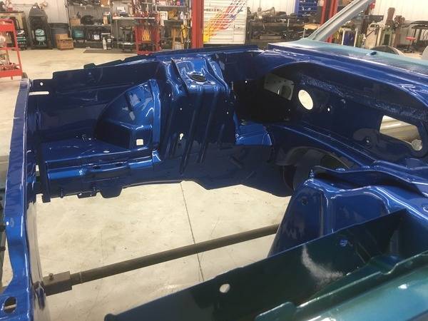

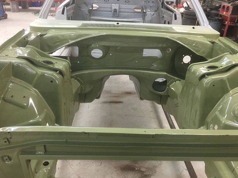

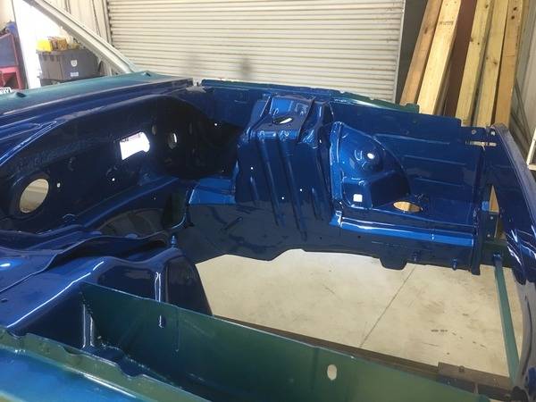

Did you sand the green base before shooting the blue?

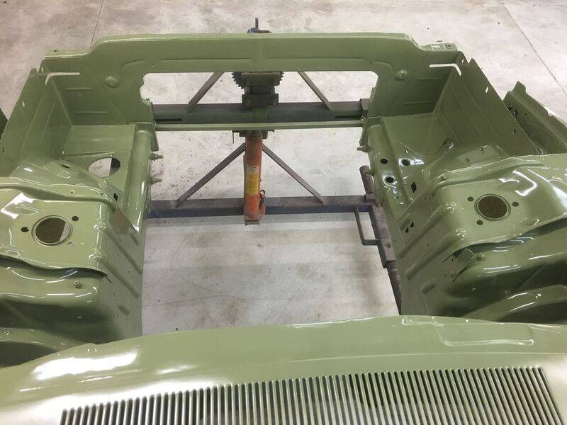

The green is epoxy. It can be used as a no sand sealer as long as your in the window for re coat. I sanded the powder coat epoxy (gray), did a little body work, and then spray a few coats of epoxy (mainly because of exposed metal due to sanding). You have to let the epoxy cure for a few days before sanding. Sand the first epoxy coat, do a little touch up body work, and then epoxy again as a sealer. Base directly to unsanded epoxy and then clear. In this case, Imron high solids. I wouldn't do this on the exterior, but the engine compartment needs a little more durability. Now if this were a show car, the base color requires a value shade 5 for sealer before base. I would have then used the correct shade sealer and then base and clear. I wasn't too concerned, as this is a driver, and the guy doing exterior body/paint uses a different manufacture of paint than I do. So it's up to him to match mine :yes:.
