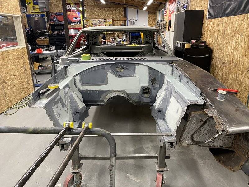

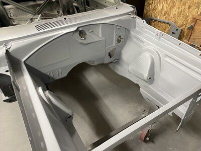

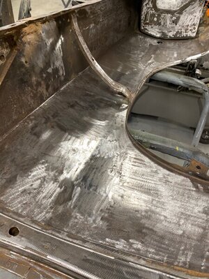

F4E58E41-E3BC-4810-B8AD-0133E8466734.jpeg 9B2CBDC5-C0E2-4EF5-8E76-89A2C565E9E9.jpeg 3B70A46A-6400-4085-B187-ADA0475584C6.jpeg

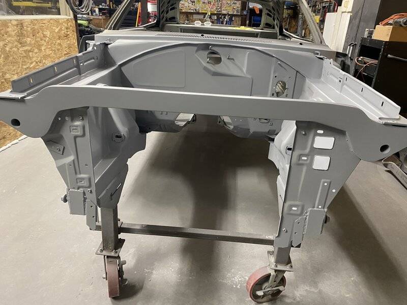

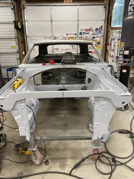

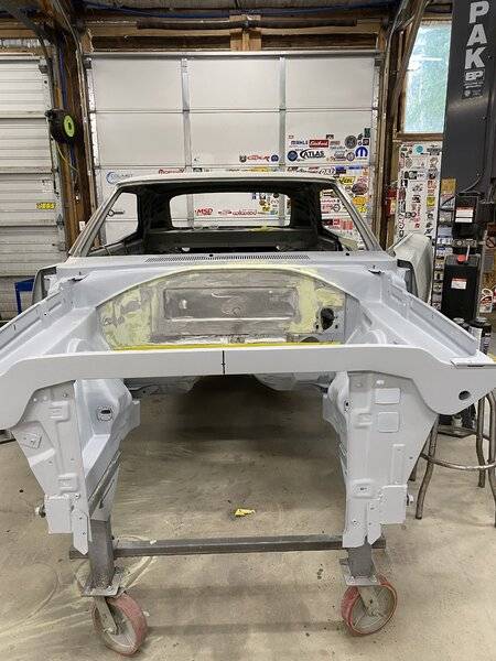

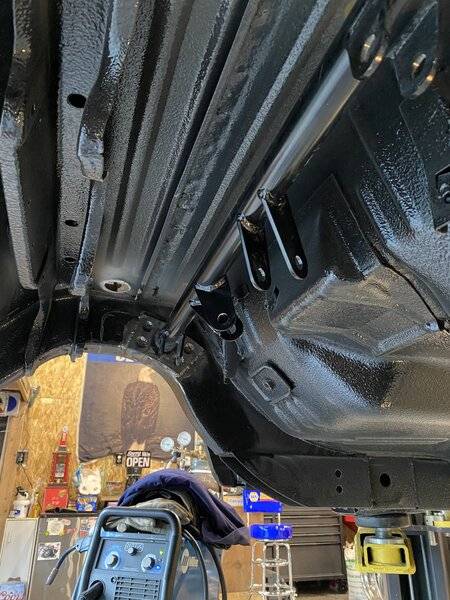

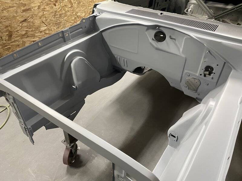

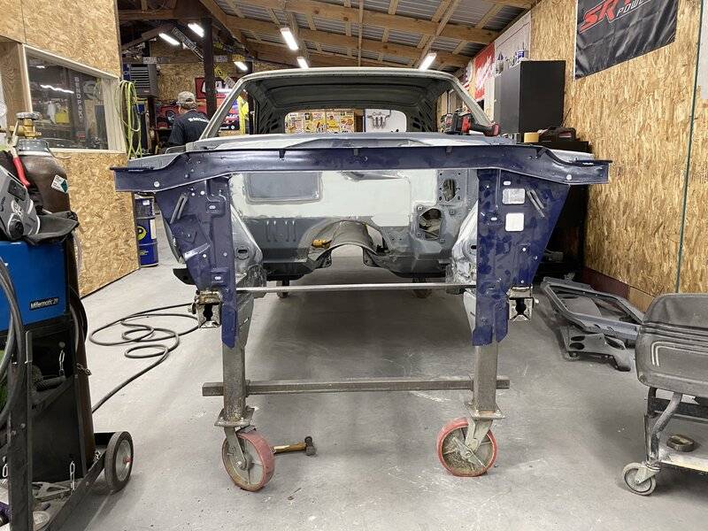

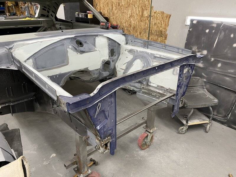

That looks really good,why did u shape the upper radiator core like that, are the hole for the front harness?
The radiator core support is for a 26 in radiator for a B body. We boxed it. The holes you see on the sides are pipe support welded for support of the inner fender.

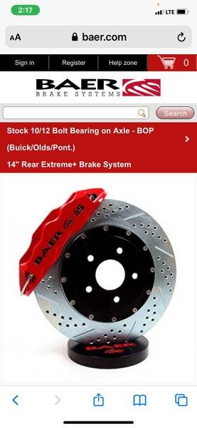

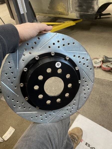

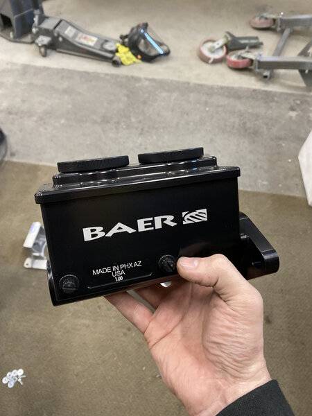

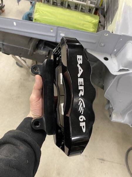

Ordered my Baer brake package, 6 pistons front and back. In gloss black with silver lettering.

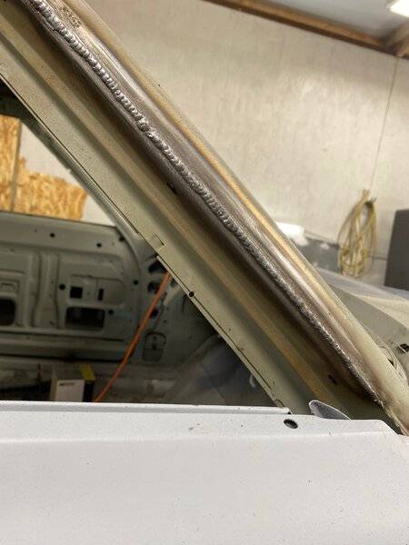

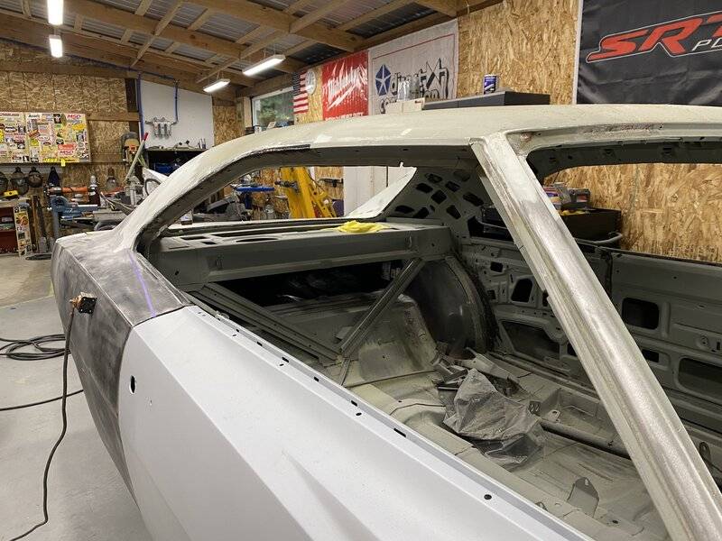

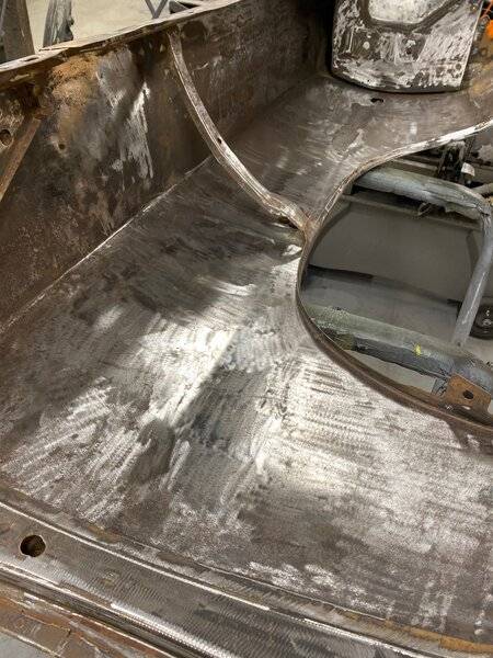

I like most of the modifications you're doing. I actually like the stock roof rain gutters though. The car will probably be quieter without them, I'll bet. I didn't read where you chose a color.

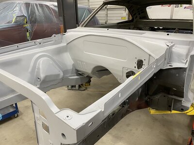

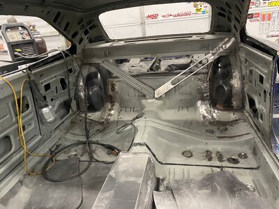

F09C7A42-ACDB-4D43-9279-F0F682013290.jpeg B87CAB1F-998A-49BE-B1B9-AE8C6CA4284D.jpeg
Black looks great on these beauties, but that grey is pretty nice and different from the norm. the grey IMO. Nice work by the way should be one hell of a car when you complete her.

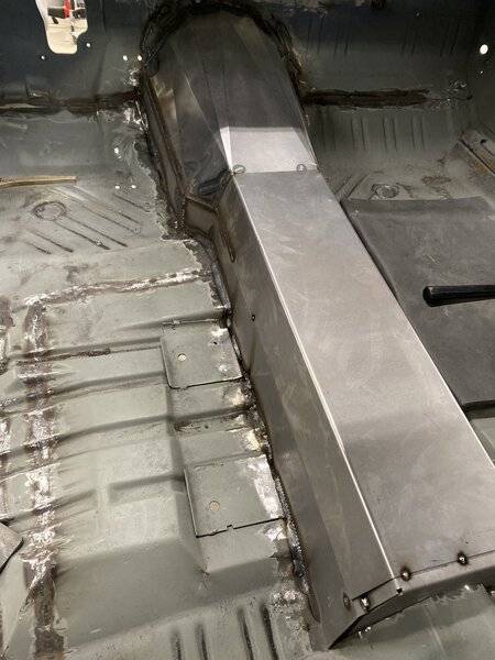

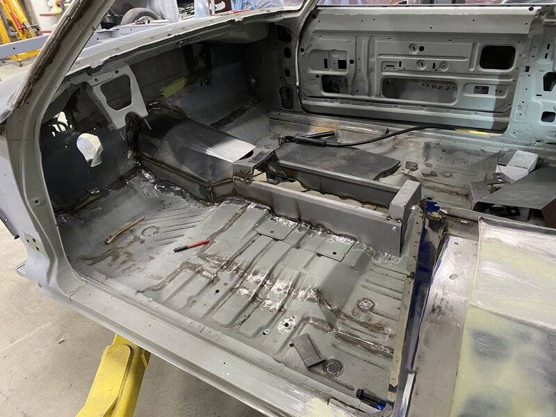

Nice work! I was looking at the US car tool tunnel the other day, if I ever get around to the 6-speed conversion I keep dreaming about. It looked like a stout piece, I'm interested to hear your thoughts on it.
Aaron, said it worked out great. He said it saved a lot of hours in fabrication. We will mock up tranny and motor soon.
