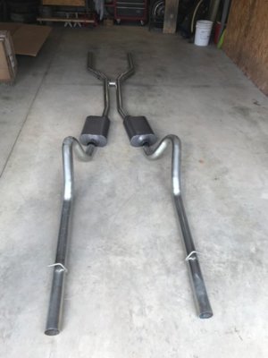

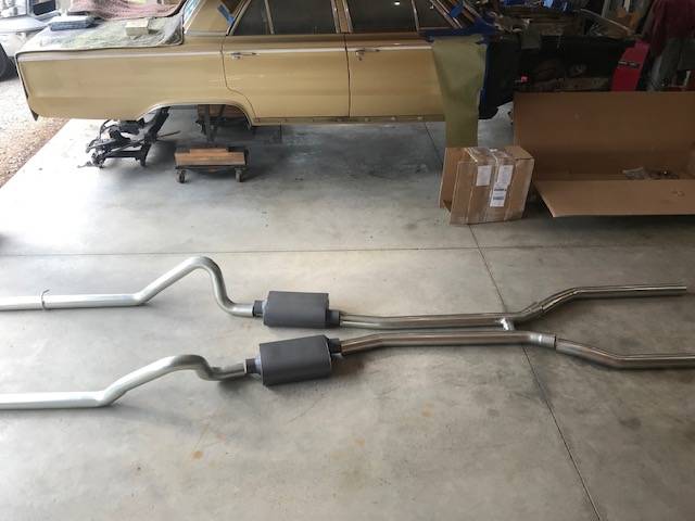

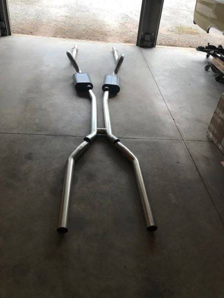

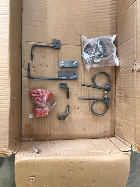

Well it arrived in about three days after ordering. Came in two boxes...one with all the tubes, clamps and hangers and one with mufflers.
First impressions. It's not a TTI system. The biggest noticeable difference up front is the hangers are nowhere near as robust. The tubes seem to be bent pretty nicely, the crossover is welded, so the pipe before the mufflers is pretty much set where it's going to be. The mufflers are painted carbon steel. No instructions whatsoever, so I'm not really sure where they plan for the hangers to attach to the body. Hopefully that will become evident once I start the installation.
It's going to take a little bit of work to get it installed, but for the price difference I'm willing to work with it.

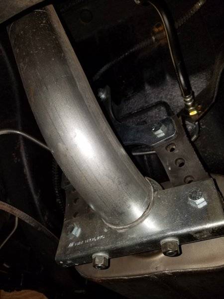

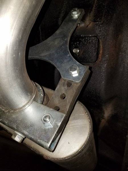

Shouldn't all the hangers be in stock locations? I realize you've put in a later model trunk so those hangers should go where 68-70 would be.
Most likely the hangers will go in the stock locations. The 67 frame rails are slightly different than the 68-70's in that the gas tank strap goes side to side and there are some extra holes for the fuel filler tube mount. I'm not sure the 68-70 hanger locations are present on the 67 rails. No big deal....I'll figure that one out. The one that has me scratching my head is the two longer brackets....I'm not sure where they would bolt. I'm actually thinking of fabricating up something like TTI offers. On my dart I think they mounted to the seat belt bolt area and used the rear muffler clamp to support the exhaust system. Any pictures of a 68-70 TTI system mounted in a car would be helpful for the hanger references.

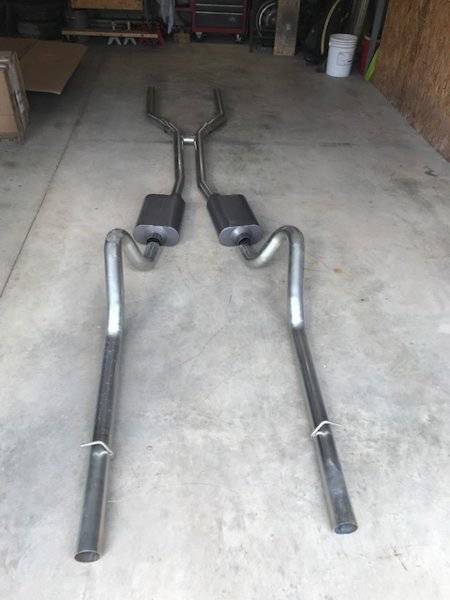

I used that exact kit in my 68 coronet r/t last winter. I knew I was going to have to modify it because i added a t56 trans so I didn't want to buy a aluminunized kit for $700+. I am VERY pleased with it. It looks and Sounds great, there is a little droning at low rpm cruising. I ended up not using the supplied hangers. I also used band clamps that were stepped instead of the straight ones. The clamps they supply won't compress the exhaust enough to seal.

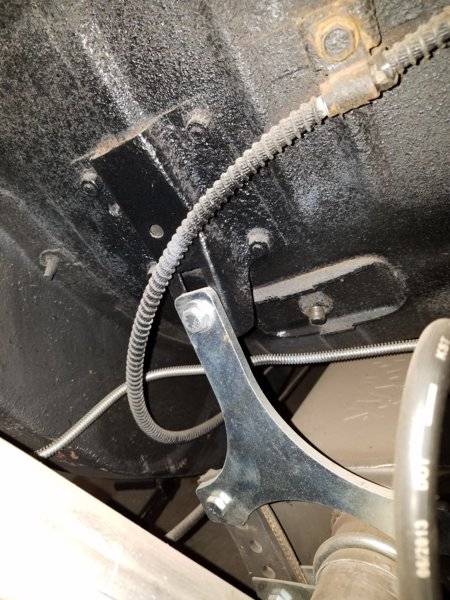

This is TTI on my 69 Runner.
