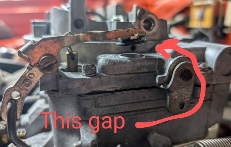

Question. The seal the comes down with the accelerator pump. My book says it should be 3/4" off the air horn. That's a lot more than it's ever been. Does that sound right? Carter avs 4617sa..

The arrow is pointing to the bowl vent valve. It can be adjusted AFTER THE ACCELERATOR PUMP STROKE IS ADJUSTED by bending the bowl vent lever tang as its it's located at the back of the vent arm assembly near the pivot screw. The gap seems a little excessive....unbend the stop slightly to decrease the vent valve opening. The rebuild kit should explain.....
