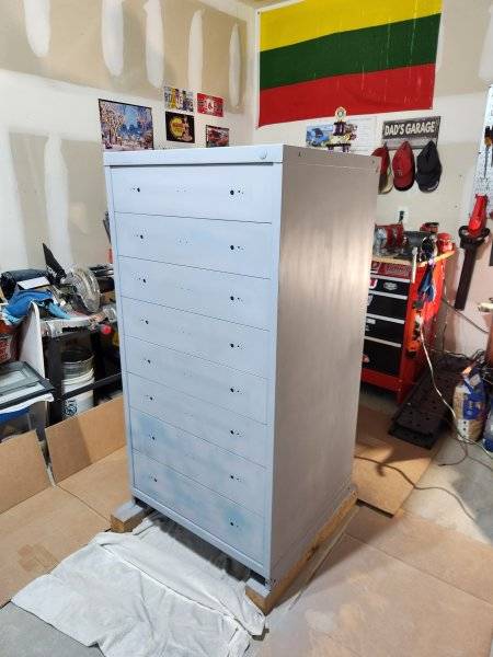

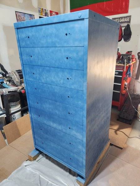

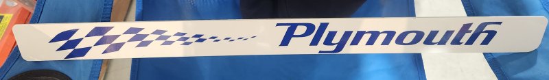

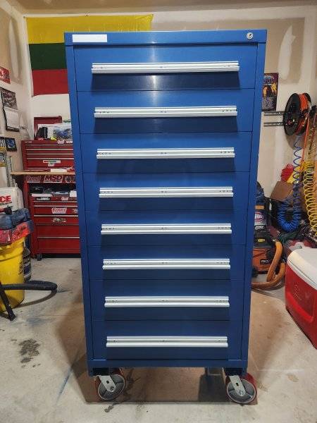

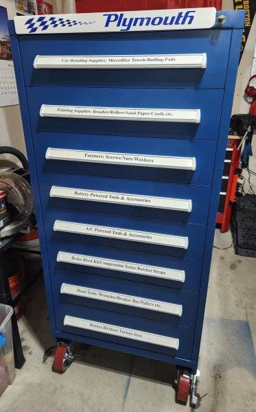

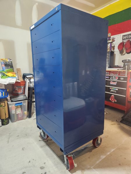

Recently scored a 90's Stanley Vidmar Cabinet from work. A manager got about a half dozen cabinets from another plant location, and "raffled" them off. I was lucky enough to get one. These are definitely top shelf units, and I'm sure glad they didn't get scrapped. Not sure how long they sat around not being used, but the 30 plus year grease in the drawer roller bearings was stiff as could be. First order of business was a complete cleaning of the exterior in preparation for repaint. Next I hit it with some 80 grit on the DA sander. Followed by another cleaning, and finally a thorough Acetone wipedown. Applied a coat of Primer in preparation for the Basecoat. I had 3.5 cans of B5 blue paint from Herbs that I decided to use. I knew I'd probably need more, so I ordered 3 more cans in the meantime. I decided to paint the aluminum drawer pulls gloss white. This blue/White scheme would match my 72 Satellite. Not exactly, since the blue on my Satellite isn't B5, at least not yet. I ordered some 6" Casters from Service Caster. They make some killer wheels with inner & outter grease fittings. Bonus that they are red, so now I have the complete Satellite color scheme! Cleaning, degreasing, drying all 48 roller bearings, before re-greasing, took longer than i thought. Next up I'll clear coat the box, before putting the pull handles back on. Lastly, I'm considering a 72 style strobe stripe, along with other Mopar related decals.
