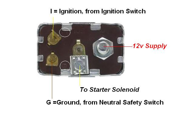

Which terminals do I need to jump? I tried jumping the positive battery cable to the large lug that goes to the stARTER. iS THAT CORRECT?
If you want to start the car by bypassing the relay altogether, simply jump the large lug to the lug in the middle. It has a square hold down with a hex/slotted screw. However, that does not test the relay.
If you want to test the relay itself, momentarily jump the large terminal to the spade lug marked "I" with the transmission in PARK. If the neutral safety switch is working properly there will be a ground at the "G" terminal. If jumping those terminals activates the starter, then the starter relay is working properly.
The wire on that lug "I" goes back through the bulkhead terminal to the ignition switch. The reason I mention that is bulkhead terminals are notorious for having bad, dirty or corroded connections.
If the relay has a bad ground or if poor power from ignition switch it will be hard on the relay
test for good ground and proper power before blaming relay
