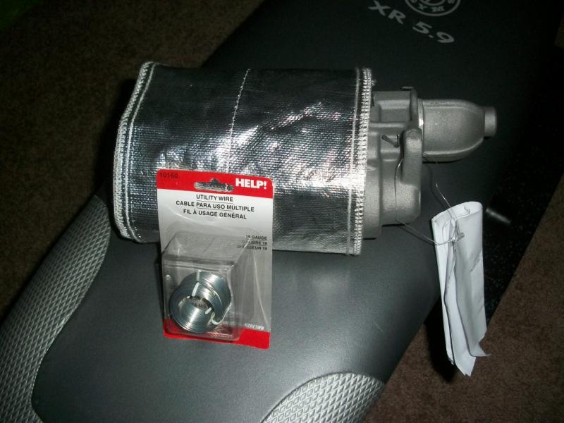

The battery is new and the cables are huge 1/0 guage welding cable and the ring terminals were installed at a shop. Based on all of your input, I will go grab this factory rebuilt starter, part number P 3258, from Advance Auto and install it tonight. I guess it couldn't hurt to bad to try since it is only 54.99, and everyone seems to think the mini starter is the problem. If a mini starter could not even handle Sweet5ltr's cool running 440 with his electric fan, then I may as well give it a shot.
I just went shopping and came back with this stuff. An original starter, DEI heat shield wrap, and some wire to secure the heat wrap in place. Hope it works. Total cost for this project is about $100 so if this works it will be a great investment. I can let you know by tomorrow night so check back.

advance auto parts "world wide" starter? If so, great choice. Lifetime warranty! A starter heat shield is a good choice as well if you have the clearance for it. When is the last time you changed a starter in the car? It's honestly a two man job without a lift. One person manipulating the header, and the other performing a circus feat getting the factory one back in.
I would be interested in your outcome as i have just purchased one of these "direct drive" Mini-starters, they need more available current especially hot vs. gear reduction oem...on my old poncho 400...which alslo love to melt starters I made a shield to keep that radiant heat off the new mini I installed ....been Ok since.
I think 230 degrees would not be unusual for a new rebuild, with that heat; high compression; tight engine and all we must deliver close to 300 amps to starter.
....if she does not crank after a shield ... voltage drop can be read during the hot issue...
