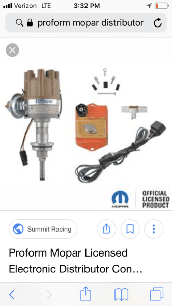

I added a mopar hei distributor last year and it had a dinky ballast resistor. Something told me to throw the original one in my tool box. I’ll swap it out and see.

Never heard of a Mopar HEI?
Yes there is a Mopar HEI, mancini only shows them for a small block. Never knew...
But the part number has '440" in it so it could easily be confused.
You can test the ballast resistor itself with an Ohm Meter, just unplug one side.
What you have shown is a mopar electronic ignition, basically an amplifier for the magnetic pickup. HEI was originally a GM thing started in the Mid 70's I believe.
I think several companies offer one they usually have a bigger diameter cap. I just didn't know there was a mopar branded one, but apparently there is:
