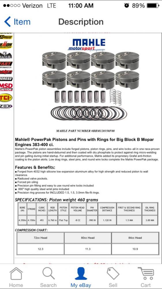

Sup guys, I'll be starting the build on my 383 in January. I'm thinking of going with the eldebrock E-street series aluminum heads. Been looking for a kit to build my foundation, any idea if this kit is good?

That said MAHLE makes good pistons and has been for a long time. Ever hear of Porsche? Guess who their piston supplier is?
