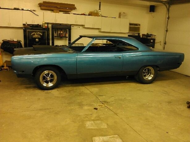

No -1" I don't have the car completed yet but was shooting for having the top of the rear fenderwell even with the top of the rim. Here is how it's sitting without anything on the car.
I'm hoping with the complete car the back of the car will settle about 1-2" from where it is here.

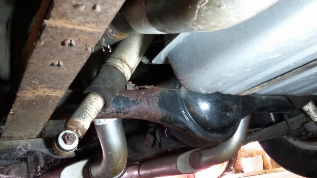

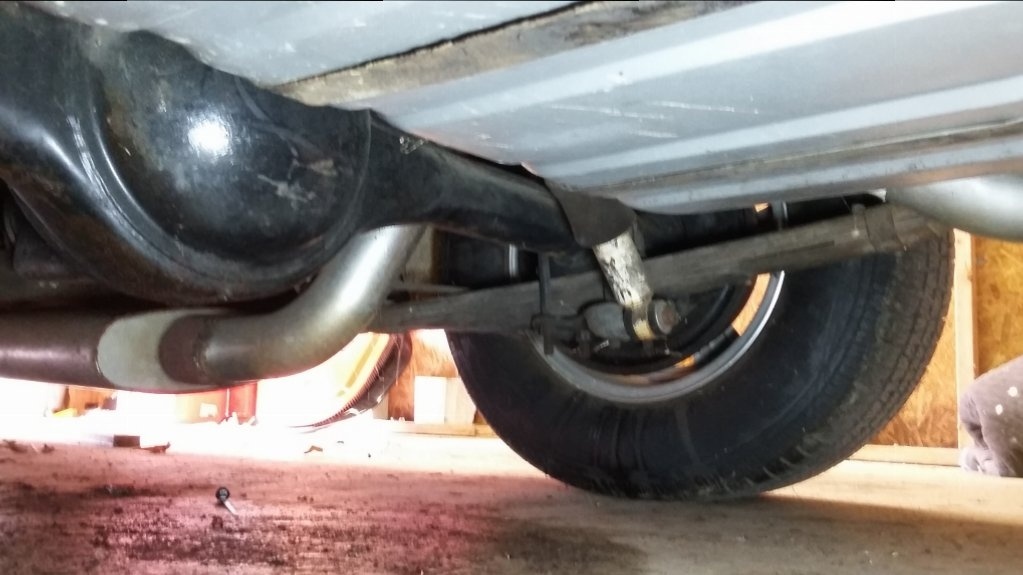

Dont realy know ,u bolts are tight,, ,,I'll see if picture helps ,Springs don't look like they have much arch, I'm thinking 47 years is the trouble , my dad didn't have right rear for car so years ago he put one out of a satellite 8.3/4 has a 290 somthing gear ,iv Got a 355 sure grup coming first of month ,,,,,by the way i sure do appreciate yall help ..
How far above or below the rim is your wheel well? Have you got a pic of the spring right back by the shackle showing the main & second leaf near the shackle. For springs, not so much the age it's the "cycles" (miles), but new springs are good. In my opinion a rear disc conversion is down the list money wise. Ran drums all around on my '65 Coronet drag car for 11 years. My '66 has stock disc conversion in front (previous owner), drums in back. Discs are easier to work on though & you do need to match the disc setup to the wheel/tire & axle combo.

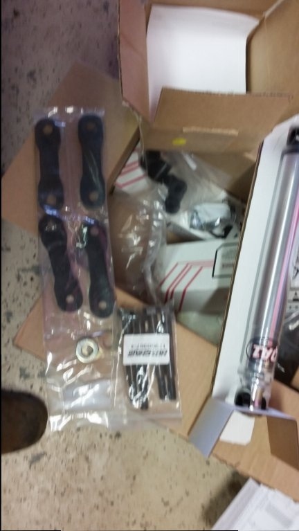

That was fast ,parts came today from summit ,Hotchkis shackels don't look like right ones,from bolt hole to bolt hole their 4 inch ,but the ones on car are bout 31/2 ,also paper that came with ,said e body ,,but when I look it up on summit site gives me same part number ,but anyway they don't look as good as picture, the shocks are qa1 look good but have seen about fit yet
