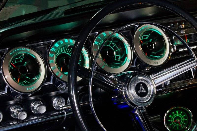

Would consider fixing the gauges instead of replacing them with aftermarket things (if that’s what you mean). Couple guys on here that fix them and do great work. And they’re beautiful when they’re working. And I’ve done almost everything with the dash still in. AC box is the only thing I can’t weigh in on. Just pull the seats and it’s pretty easy to get up behind it. Also, I love my retrosound radio
Hey Captain, You should consider having your gauges and cluster refurbished, it the coolest thing about these first gen Chargers. Contact Todd, he does repairs and restorations of these and does excellent work. Home - Todd's Restorations

I agree with the stock gauges
I think you are asking about the instrument cluster, heater radio. If that is it, they will come out without removing the windshield. The bolts holding the dash are under the lower w/s gasket.
@CaptainAtom there are no aftermarket gauges that will ever look better than this. IMHO, the most beautiful dash that Ma Mopar ever created. Have your dash restored. Have the factory radio updated to modern bluetooth capabilities if you want a "stereo".
